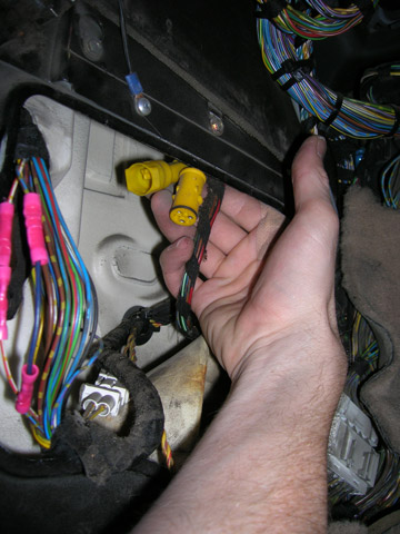

    we go way back... you've seen this pic already, and this one and this pic where you can just see the fix on the left. (i admit i used i slightly higher guage wire there i think... pretty sure the fix is good tho) That's the only place where any of that 5lb. pile of wire was spliced.
    Where else can I check that you might wire an alarm?
    Weird thing, just happened, maybe related... I mentioned already the running lights flicker ever so slightly when I reconnect the cable at the neg battery terminal. Well today when I first reconnected the battery the factory horn went off... first time this has ever happened on just connecting the battery. I say factory b/c there are aftermarket horns installed... the factory horn only goes off when the factory alarm (code on obc) is tripped... if I use the steering wheel pads I get some kind of pissy euro horn pair that hangs around the power steering reservoir.
    Anyway, I'd rate this BS alarm as suspect #1 at the moment ... wtf?
    Two alarms on this bitch? wonder what they were haulin'?
    As I'm sure you can imagine any ideas, no matter how whacky, will be gratefully received, but I'd say it looks like I've had the same problem for a while now.
