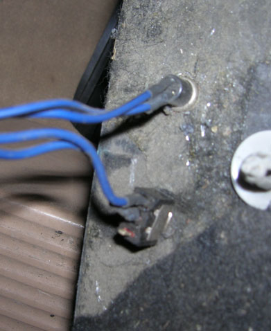

    flicked the switch on and off (or off and on?) and my battery died the next day but that must be a coincidence... it went below freezing for the first time (i think) last night too.
    but if the switch kills the battery, i hate to think what the red button might do.

    That does not look stock to me... pretty mysterious, I'd want to look into figuring out what that is, especially if it drained the battery (still active for something). What was the check control message you got?

    im guessing an aftermarket alarm system that dose not function anymore. switch for on-off red button for reset

    +1 for the alarm. It looks like a toggle switch for an on off function - some alarms need a switch like this for remote start on/off. The other looks like a valet switch for the alarm. You use it by pressing it in different combinations to access different alarm features.
    That is IF thats what they are - does seem in keeping with the battery situation though.
    They definitely don't look factory.

    ...so i investigated a bit more, and i think i had switched it on. it seems to drain faster with it switched one way but it's hard to tell as the readings i'm getting show the battery losing voltage at varying rates either way (i'm using a hand-held voltmeter now as the obc is a PITB to unlock every time the battery goes under 11v). i will see if she starts tomorrow...

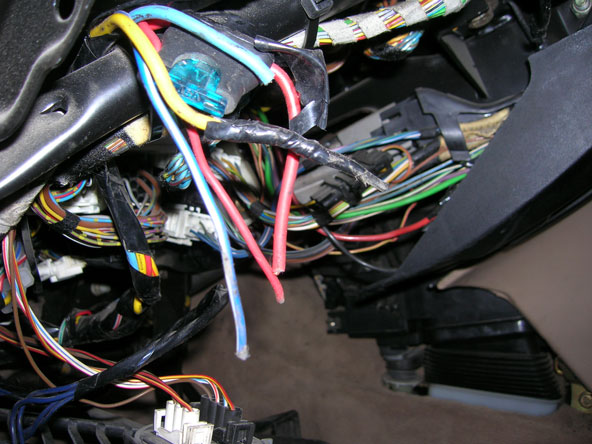

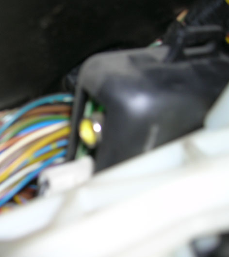

    the switch and the button are wired to this mysterious black box, it's jammed in really tight behind all the wires behind the pedal trim panel. i think i can get it out but for now i am afraid to put too much pressure on all the wires... i can't really see all of it but i can see an rca type (yellow... video?) jack and two clip-plugs (pretty typical looking) with 4 or maybe 6 wires coming out of each of them... can't trace them yet, i will have to go in there more thoroughly. sorry for the blurry photo, my camera couldn't focus in such a tight space, but does it look familiar to anyone?
    what is really scary is the third photo, don't you think? i am going to have to read up on my laws of electricity because right now the only way i know how to check for a live wire is with my tongue. i think i will curl up with a good bentley manual tonight.
    could it have been some kind of dvd player or satellite radio? i found some cut leads behind the stereo the po had installed.... i don't think he did it himself and i bet he never knew what the stuff under the dash was, so it's been there for a long time
    i will check the voltage and pull some fuses... thanks drEvil! electrical has been running 100% well since i did some basic maintenance (plugs, dist. and cap, icv, oxygen sensor)in july but now i can definitely feel the drain on the system from the battery going down to such a low voltage. (the engine idles much slower now until the battery is charged)

    maybe those loose wires are grounding against something. wrap tape around the ends. not together, of course, but each end separately
