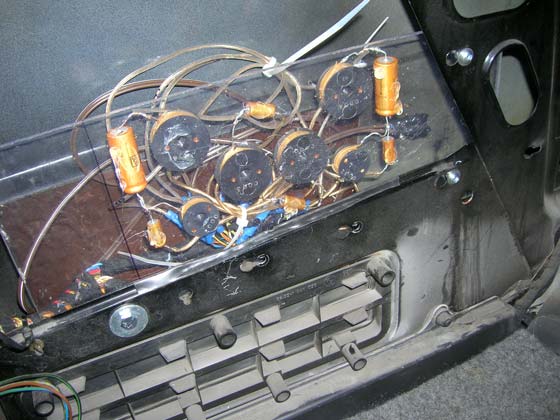

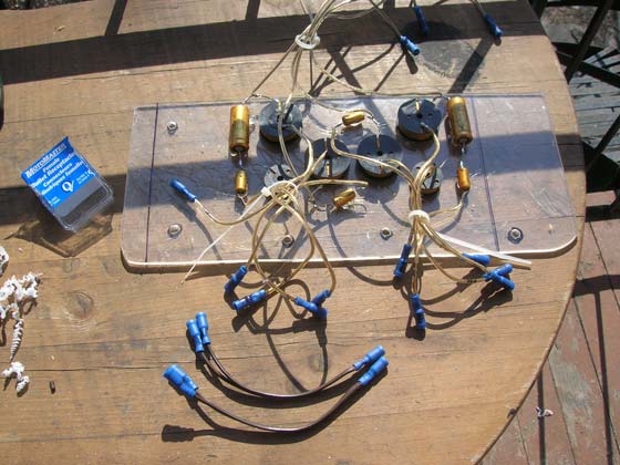

3. Hot-glued all the pieces to a piece of plexiglass and then made the connections...

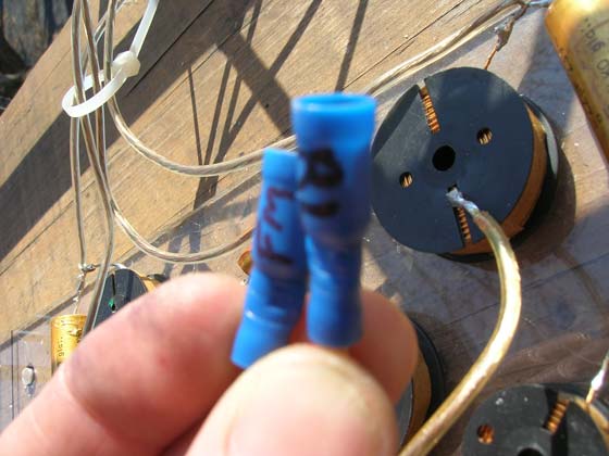

4. These little motomaster plugs are very handy, you'll see why later. Here are two labled for the front right mid speaker and rear left woofer.

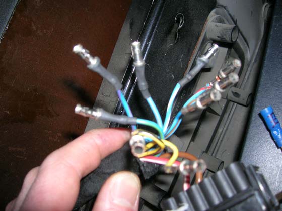

Ready to go- NB there are two separate spliced cables in this photo. I made them with the intent of using the factory wiring for the speaker negatives, which worked but screwed up all the fading. In the end I had to use separate speaker negatives for all 4 corners and wire them straight to the head.
