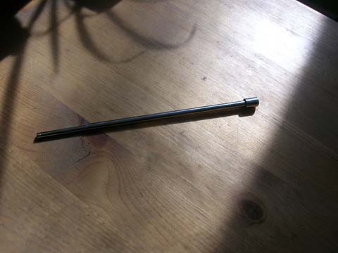

    I have made my own using ss or brass tubing from the local hardware store. Just push the tube over the pins and it will push in the little flaps and then you can push them out. Works pretty easy and its a cheap repair. Only cost about 2-3 bucks for a 1 foot piece of tubing.
    I made my one fron an old antenna, just cut at the right diameter and it is a perfect tool. You can even insert a knitting needle inside to push out the pins.

    That works perfect! The smaller bit of antenna even works to push the connector out.

    yep, that is nice. I just made a new one from a telescope magnet I bought in a
    100 Yen shop = abt. $1. Diameter is nice small

    Sometimes you have to unlock the plug in some way. I found that out on the plug for the MAF. Could not push the pins out, first had to unclip on the other side some small clips and pull that stuff first, the the pins could get out.
    see from pag 6, retaining lugs

    here the telescope magnet thingy
