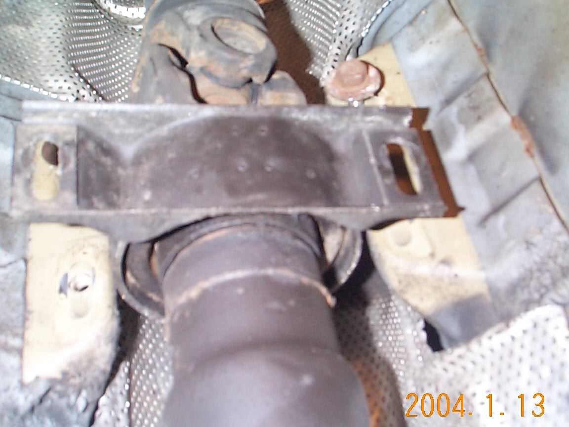

    Tomarrow I will be installing the new center support / bearing. What is the best method to preload this thing to prevent shakes / shimmies??
    Thanks a bunch
    Pre-load the bearing by sliding the bracket of the center bearing forward (toward the engine) 4-6mm from its ‘neutral’ hanging position prior to fastening.
    Hope this is the photo I'm think it is.

    Default Dave, its 2 to 4 mm not 4 to 6 mm...

    because of the confusion, maybe ill go with 4mm exactly! lol
