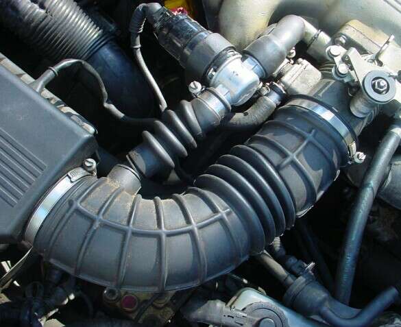

    Hi,
    Upon inspecting my M20 525i (1989), Dutch (Euro) model, I found this sensor (?) which seemingly is disconnected. But I can't find where it should be connected to and I also don't know what it does.
    The electrical lead (top left one) goes into the cable-tree.
    The other one (non-electrical, bottom left one) goes to some kind of the filter in the left-front of the car, next to the powersteering fluid reservoir.
    What does it do and where should I connect it to ?
    Thanks,
    Ed,
    The Netherlands

    it's part of the fuel vapor system and is usually connected to vacuum

    OK.. Thanks.. The problem, however, is that I can't find any vacuum spot I can attach it to. Should it attach to the gas house ? Or to the rubber hose in between the air-meter and the gas house ?
    The car doesn't seem to run any different, so perhaps the previous owner made some modification such that there is no more vacuum spot to connect it at ?

    you have a m20 that's easy then it goes onto a nipple on the bottom of the throttle body (at least on usa cars)
