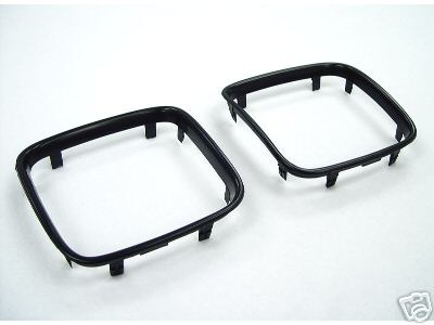

    Hi I bought a shadow/blackout grill to replace my chrome kidney grill. I'm not sure how to remove the stock one w/out breaking it. Also do i need to remove throught the engine bay or can I remove from the front. Anyhelp would be great.

    Here's a pic of what I got. I think I know what clips u are talking about. So first I need to remove a screw from inside the hood?

    Oh, sorry, my instructions are for removing the whole grill assembly, not just the kidneys. I've never removed the kidneys from the grill assembly, so I'm not much help there.

    I would think if you pulled the whole grill off, like in my instructions, the method for kidney removal would be pretty obvious.....
    Haven't tried it, but it seems like it would be pretty straightforward, and it only takes 5 minutes to pull the whole grill.
