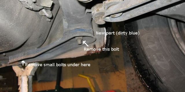

    Anyone ever do a photo install of this? I know BMWE34.net has the recomendation of them... but I still dont have a clear idea as to where these go...
    Ive got them sitting in my bag of goodies to install this weekend and Ive been searching for a good pic of where to remove the bolts (and Ive read horror stories of people snapping the bolts)...

    Default Here ya go..
    I'm glad I keep every pic I download...500gb later...
    Thanks to whoever took this pic and labelled it.
    Ramon

    Eureeka! Perfect!....
    And rehosted on my site JIC anyone needs to link it.
