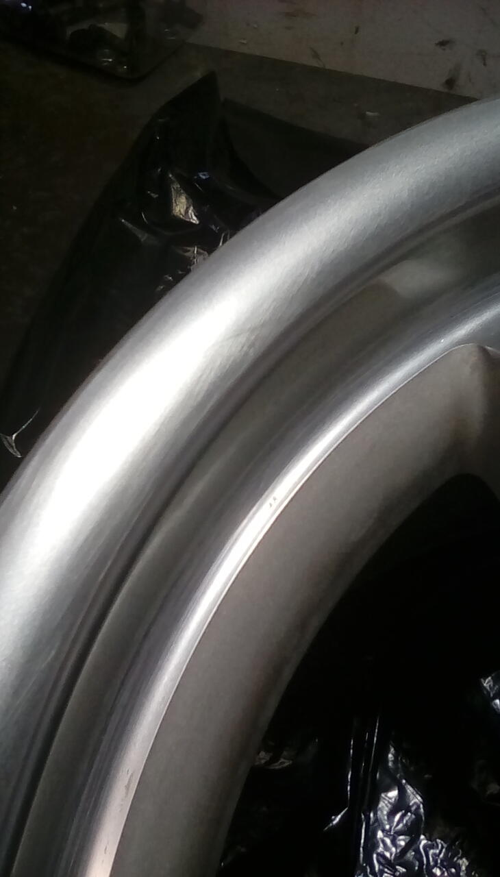

    This shyt is unbelievable if it's a coating. Strippers wont touch it at all. I sanded it a bit and stripper didn't see it. I'm thinking something in the forging process which doesn't make sense. Whatever. I used a DA and 150 I think, old paper that got oil on it and blows apart ... nevermind. I only did the lip, was supposed to figure how to grind the barrels but didn't have time yet. And I took a picture of that but it didn't show up so that's missing. I'll post what I got.
    I sanded the complete lips on all 4. I am committed now. Just need to figure out how to cut this layer without messing it up.
    No power sanding materials at the tool store so I grabbed some 150 to cut the mystery coating. Wont work with water so went with dry sanding. About 2 hours I almost got one barrel done. Almost. Then there are 3 more, I cant wait! I have read everything I could find before jumping into this, there is no coating on the aluminum. They are all wrong. Yeah I know, no pics.... sigh. I need to force my little ipad or whatever it is to work on this site so I can post pics. Just thinking of options right now, this hand sanding sucks.

    400 grit on da. Name:  IMG_20220402_203036.jpg
    Name:  After sand and 1st polish.jpg
    DA sanding is okay, just not good if you don't see WTF you are doing. This is not like painting a car. Very different. Trying to buff or wheel you will see that the da sanding failed. Resanded with 1000, 1500 and 2000. Then used the drill buffer taking time with the cutting stuff. About done with it, 3 more to go. I will never do this again. Ever. Just buy the wheels you want and be done. If I ever finish this I'll get tires and hope the wheels are straight.

    Now the issue is that soft aluminum shows micro scratches. From the 2000 grit. So I go through the polishing steps on all wheels and it's not a bright mirror finish, more like a milky semi shining finish.
    Through a 10X loupe you can see them scratches in vivid detail, bazillions of them. The scratches that remain are from the compounds I have been using and not the 2000 grit paper. Trying to avoid anything with oil or wax cause I have to paint the silver stuff and then clear the things. I tried 000 steel wool which enhances it's own scratches but leaves a different look lol. Should I re-sand it with 3000, 4000, 5000 then 10,000? I don't think so. I think I will try some paint swirl remover with the buffing wheel and see how that goes.
