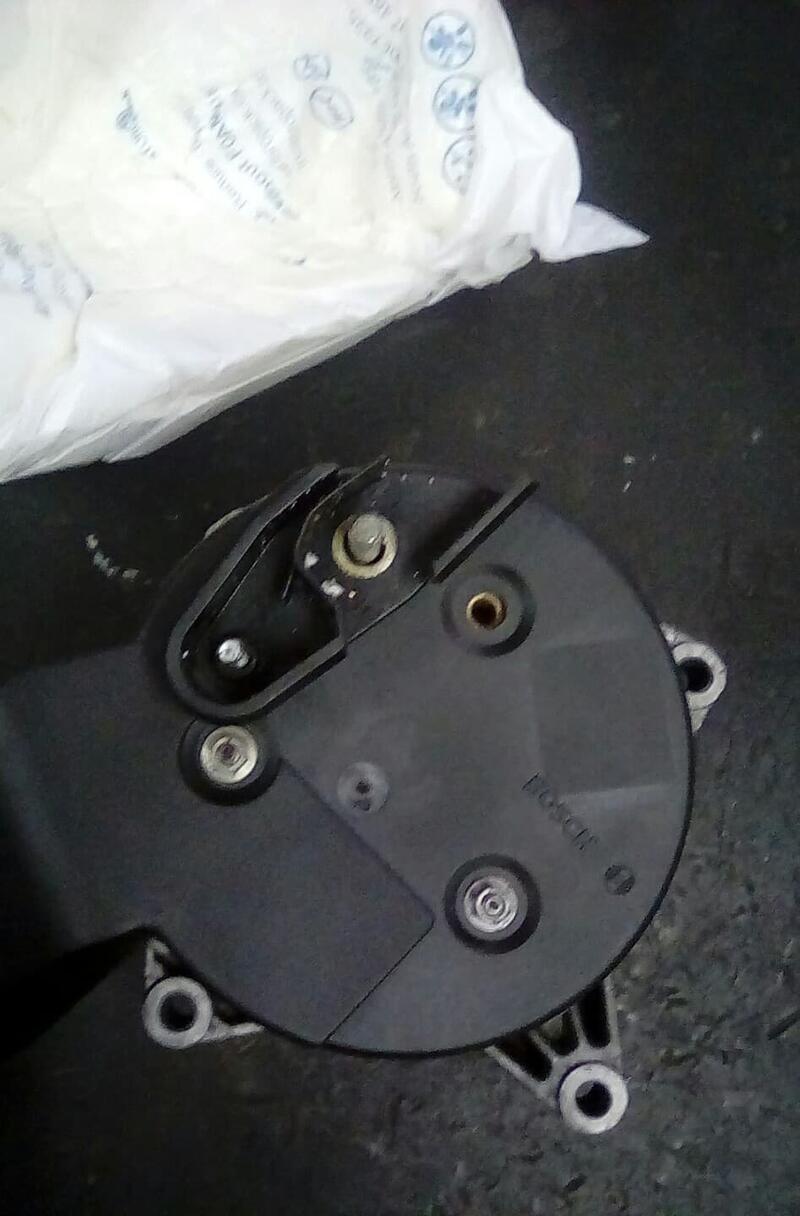

    So I got a reman because I didn't want to wait on the shipping and return for core charge for a genuine Bosch reman unit. I will now go for the genuine Bosch which I should have in the first place.
    This is right out the box. Missing bolt no biggie I can replace it with one from my old one. Noticed the stripped ones on the front that hold the bearing. I guess they didn't need to replace it because they were unable to remove it. SO I have to remove the cover to replace the bolt / stud thing.
    This thing is covered in ground metal like it was stored under a grinder or something.

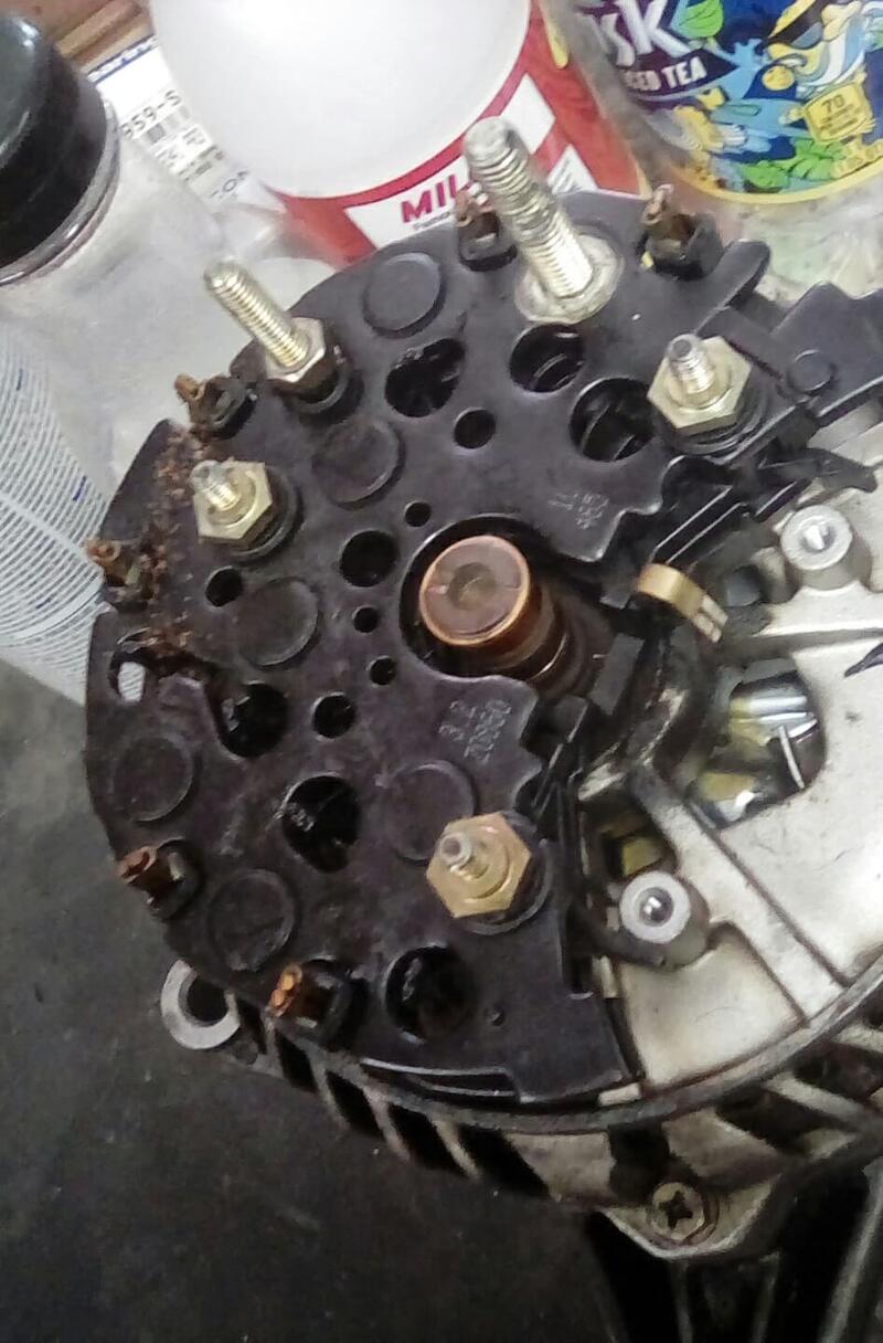

    Here are some proficient soldering skills
    My old alternator for reference
    Name:  My old one.jpg
    Reman regulator on left vs my 160K old regulator.
    Slip ring is .012 off center, that should last a long time combined with the worn out brushes.

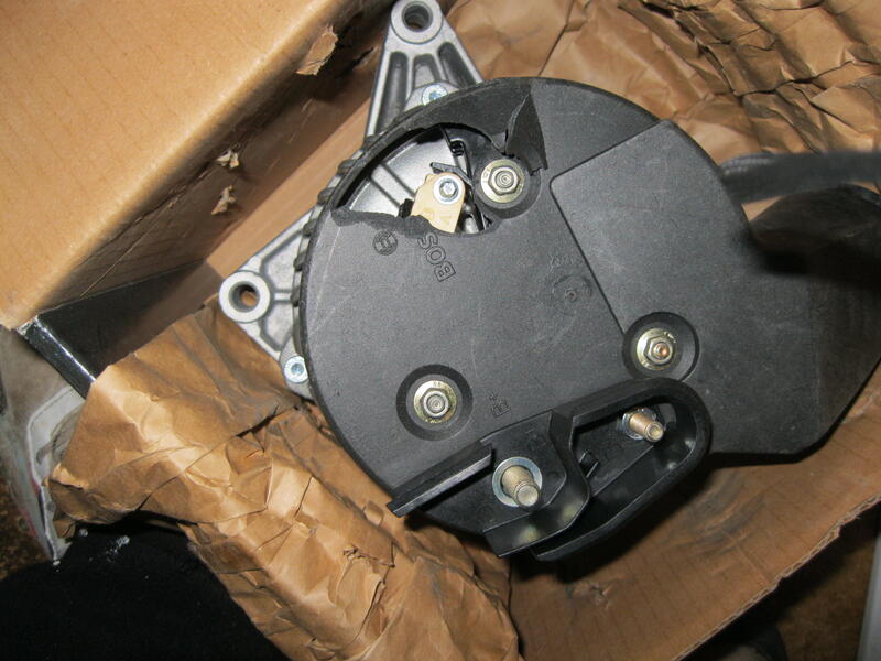

    My Reman Bosch just arrived!
    They are unable to send a replacement because they have none in stock.
    Inside looks fine. Not sure what to do yet, emailed Bosch and waiting on a reply.

    Now compare the rectifier connections to the other 'rebuilt' one.
