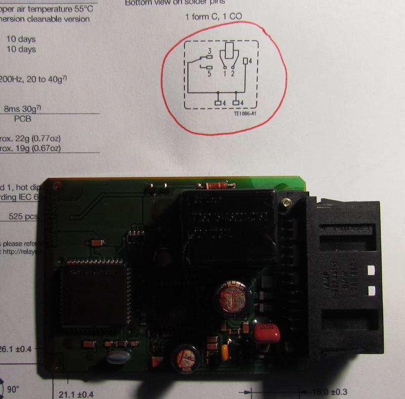

    Shogun – attached is a photo showing the EWS3 circuit board(I removed the circuit board from the EWS3 box) and an internal wiring diagramof the Tyco #Y23076-A3001-C132 relay module used in the EWS3. Terminals 1 & 2 power the relay modulecoil.Terminals 4 & 5 are connectedto the (2) large male spade connectors on the EWS3.If I jump between the (2) large female spadeconnectors in the plug that connects to the EWS3, the starter should spin – butis does not, no sound, no clicking sound like a starter solenoidenergizing.Any thoughts?

    Shogun - From my voltmeter, I see 12 volts at one of the wires feeding power to the EWS3 contacts when I turn the ignition switch to 'start'. When I jump between the relay contact wires of the EWS3, I see 12 volts at the other contact wire. What I don't see (or hear) is the starter motor spinning with the ignition switch in 'start' and the jumper in place. Fuses F14 and F67 in the glove compartment fuse box are good - they feed the EWS3. Still no luck getting the starter to spin - I'm suspecting the starter solenoid. Any thoughts?
    I'm not Shogun (!), but on X3 as it is was designed to accommodate CANbus it will be implemented differently to E31/2/4/6. Should be more like late E39 and E46.
    All I know is that you need several inputs to allow start, not just the code from the key transponder, and the rolling code check with the ECU, but numerous inputs from body electronics which in the older cars are just high/low voltage signalling coming from the alarm module (DWA), OBC and crash relay (etc.?). Any one of these going high/low to indicate a trigger will prevent start but not run via the EWS3 module.
    On a full CANbus car (not semi-can like early e39) you would need to know what the signals are- eg voltage, PWM or is it a CANbus message? In which case it is a good idea to sniff the messaging on the CANbus before going to far (again, assuming your EWS/DWA is going over the CAN which early EWS 3 as linked by Shogun does not, AFAIK- I've not looked at X3/EWS 3.3 yet). Not sure this is helpful to you, sorry I cannot contribute any clearer clues.
