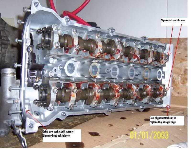

    Yes, it is possible to do the job with relaively basic tools. When I did a couple of head gaskets, I bought a cam alignment tool. Wasn't pricey, probably ~$40-50, but you can do the job with a straight edge as long as you're careful to align things if they get moved a round. For the timing chain tensioner, I used a safety pins, great investment that I still have in my toolbox The other 'special' tool is a female torx socket ground down to fit inside a bolt hole (see pick below).
    Good luck with it,
    Dave

    Oh, your vanos will look a a bit different than my non-vanos head, but can be disassembled with basic tools as well. If you have idle/runing issues, might be a good time for vanos seal replacements.
    Dont look like the straight edge will work with the M60 because the top part isn't machined like the '6 engines... But, looking into options.
