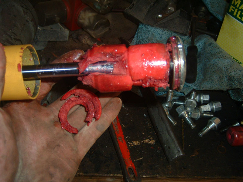

    Now the rattle you are experiencing is most likely due to the strut collar nut #3 http://www.realoem.com/bmw/enUS/show...diagId=31_0142 not being tight enough. I use a pipe wrench and a 4 foot bar to reaf these things down. How these struts work is an interference fit and if the collar nut isn't tight enough the strut will rattle up and down in the housing. I hope you cleaned the old oil out of the housing good, if 1 little drop touches a Billie it will become garbage over night. Ask me how I know.

    That picture is a shocker! (I still remember it from the day you posted it- it looks more like you opened up someone's intestines). Are you sure the engine oil in the strut casing seeped in and caused that? Doesn't Bilstein recommend a little oil for cooling, ie sinking heat out of the shock? Maybe your struts had synthetic oil in there(?), as those stops are likely only made from butyl rubber.
    The Billies have a little V-indent to alleviate pressure to the bottom of the strut. It seeps air in and out. If it smells oil the bumpstops will desintigrate overnight. The Billies hold all it's dampening oil on the top in theory using road air to keep them cool. Good design except I am NOT a fan of the garbage I replaced many times.
    So far my cheap chinese struts are holding their own. I figured a total fail by now but no deal on the fail. Sensens I think was the brand, ($60 US for both? Have to check my earlier posts on this). They are small for my strut tube but provide the right collar to center them. And I filled that strut tube half way with good used 5W40 synthetic to keep them cool. Most dumped out but I know there is no air or hot spots happening.
    I have used the Billies many times on great reviews but personally all I got was PITA with them And they ride like S h i t in comparison to the Boge/Turbo and the China Sensens.

    Now I see the reason why this oil trouble happens, with some shocks you need oil for cooling, but with some you don't, e.g. if you have twin tube Billies, make very sure any oil is removed from the strut casing prior to installation.
    IIRC this is what their instructions say, though they do not mention that this is opposite to factory procedure that calls for 30ml of std engine oil to be present in each strut before installation.
