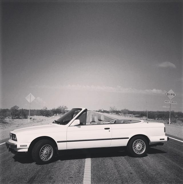

    Hey there,
    I have a 1991 325i e30 convertible. Recently I noticed a squealing sound coming from the rear wheels area. Usually around acceleration. Ive looked around some forums but haven't seen anything that sounds like mine.
    Also Have noticed a clunk when I change between drive and reverse and park. Happening more and more..
    Any and all is much appreciated.
    Thanks!
