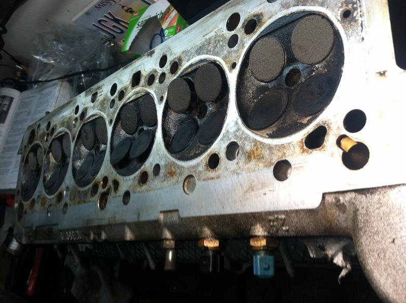

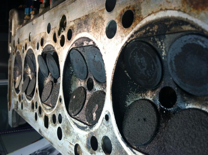

    nothing obvious to me.
    head out... 7 hours including lunch, labelling and bagging... and way to long to figure out how to unclip the power side of the injectors....
    a few pix... any ideas?
    have to find a head machine shop around here... biloxi, mississippi... afraid folks will flip on an alu do hc "bmw" head.
    HOW HOW HOW to get the cams out? can I use the tech article at pelican parts?

    Coolant in the spark plug holes... All of them?... I would look at the top of the head and see if there is a crack in that vicinity. Take it to a reputable engine place. They will break it down and find the crack.
    Did you have it resurfaced last time you took it off?
    Oldham, England
    3,078
    The Pelican parts method worked fine for me. It says you need two pairs of hands but you can do it on your own. Just don't let the cam twist. The only issue you may have is when you come to reassemble - it is quite difficult to get the first nut started.
    I'm also curious to know how you get coolant in the plug wells
    Looks quite oily, burn a lot?
    The injectors should have a clip that needs to be pressed in to pull the plug out. On the ones I couldn't get to I carefully worked the clip off completely then put back on the plug after.
