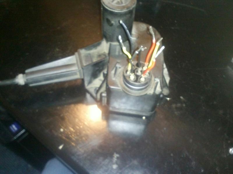

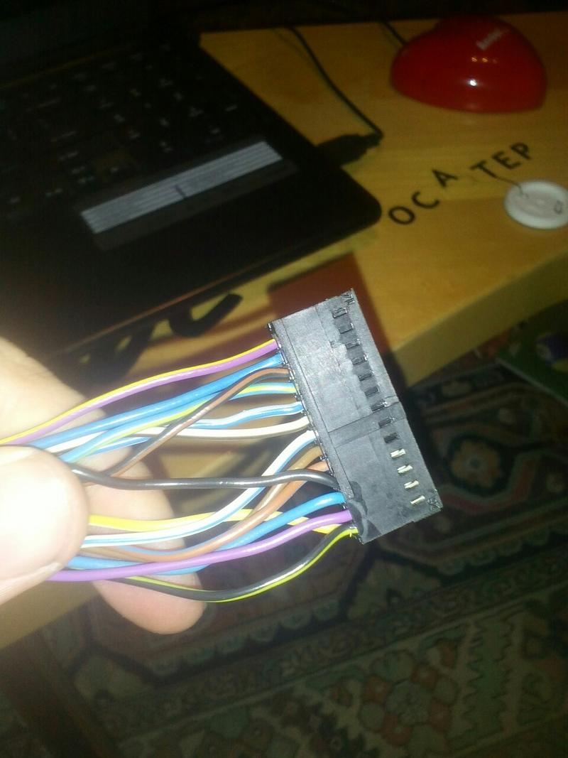

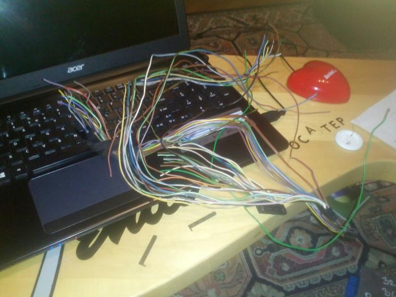

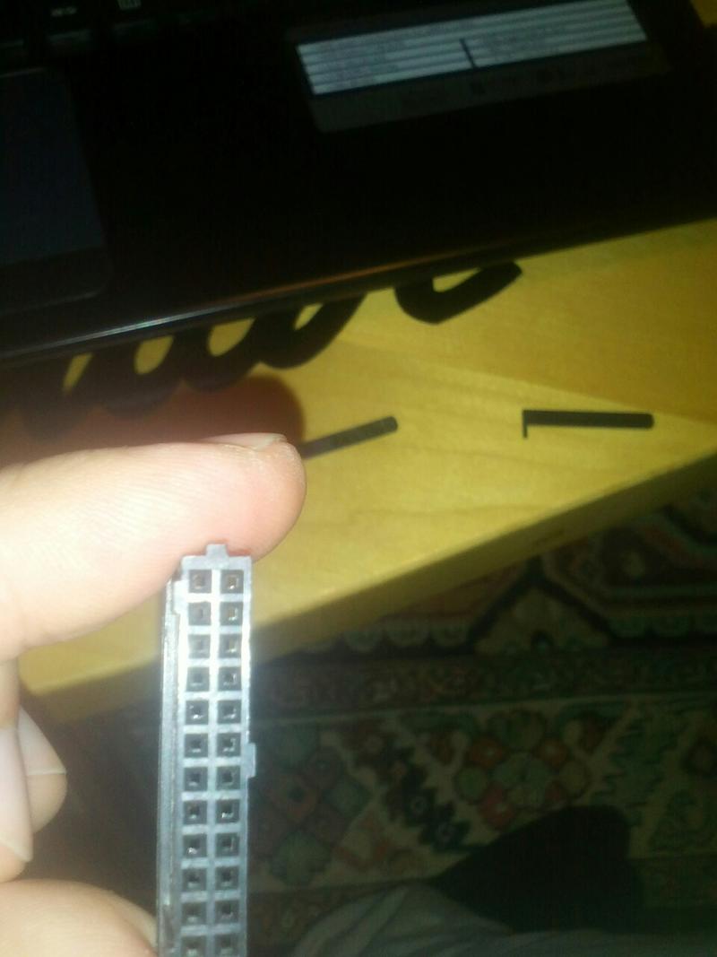

    As you can see I managed to remove the wires from the connector I've obtained. The reason why I did that was because the wire colors didn't match. So I re-pinned the connector according to the ETM and got myself a new connector. Now, I'm on my way to connect the wires from this connector to the actuator, as you can see on the last picture. I will post more picture as I move on. Cheers and thank you all for your help!
