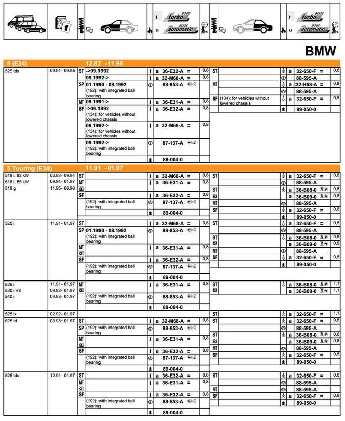

    I thought by "turbo" you meant "turbogas", as in Boge Turbogas. I saw this number 36 747A and thought the "A"
    designation in this number probably means its an Automatic as opposed to Turbo.
    Checked the Boge catalog, Turbo struts are designated with "P" (36-676-P):
    (Boge and Sachs catalogs are taken from here http://www.zf.com/corporate/en/produ.../catalogs.html)

    Quote Originally Posted by Rustam View Post
    Thank you Jeff.
