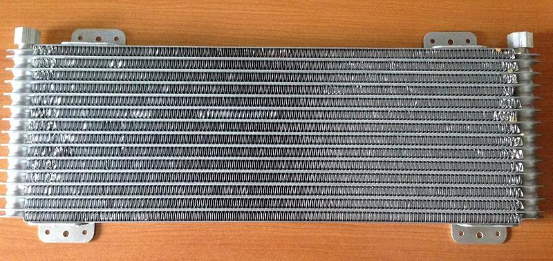

    Hi guys, anyone know the internal diameter of the transmission lines. I want to run an external transmission cooler in the car. I am thinking of cutting off the line near were they enter the radiator and putting on come tube adapter fittings and then running some lines to a trans cooler that I have.

    For reference here is what it looks like. There is a large thread talking about the cooler here, but its not for e34s.

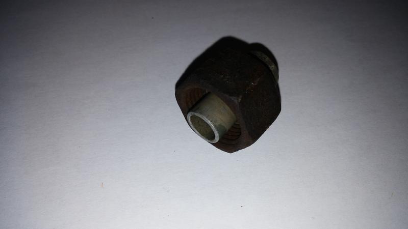

    Quote Originally Posted by BigKriss View Post
    Found the fitting going onto the radiator of 535 at transmission line. The internal diameter at the end is just under 8 millimeters. The outer diameter is about 10 millimeters. The diameters at the main extent of the pipe are larger - internal about 9.5 millimeters, external about 12 millimeters. Please note that this pipe, despite having the internal at the end of 8 millimeters, does not perform the same as a pipe that has 8 millimeters internal diameter through out. A pipe having entire length of 8 mm internal diameter is more flow restrictive.

    Thanks for that. Look like 3/8" ID pipe size is what I need.
