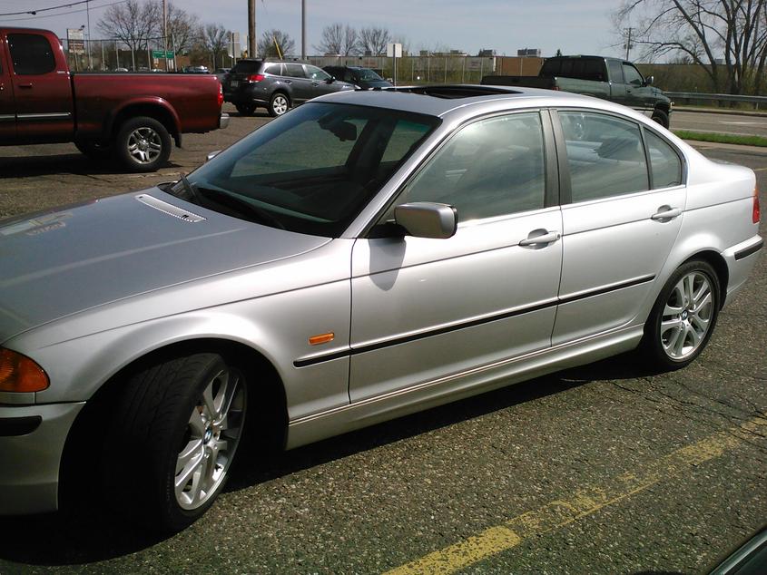

    My world changed last spring when I purchased a 2001 330xi. Cars were a necessity and I never gave them much thought…. until now. What an amazing piece of art the German engineering is, comfort, handling, speed. Needless to say I fell in love with the little bugger. Then life happens as life always does and I was forced to sell it for a song (I didn’t even get to test it in the snow.). I vowed at that moment that I would have another.
