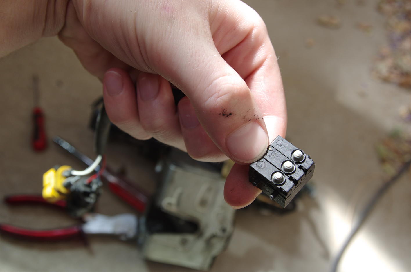

    Initially the doors were stuck locked and closed which means I couldn't get into the door. As stated in my first post; I couldn't unlock the door via the boot/trunk. But one day it did! Thankfully.
    So I left my doors unlocked for a number of weeks until parts arrived and the time to do it.
    I went for the micro-switches in the drivers side door (pictured). These 3 switches make the car: locked, unlocked or double locked. They are pressed by the cam lobes on the lock barrel, for those who don't know.
    Well, one of the switches (the "lock" switch) wasn't clicking like the others and figured that it must be stuck "ON" hence why couldn't unlock the doors and my windows would whined up when I turned the car off. A test with the multimeter on the 4 pins on the plugs also indicated that this switch was not switching.
    So replacing this switch block solved the problem.
    Part number: 61311390886
