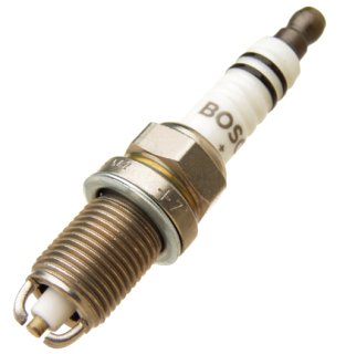

    Quote Originally Posted by Tiger View Post
    Use regular plugs... not those +4 junks... single one is best.
    You mean the dual ground electrodes, Bosch FR7LDCR (BMW OE)? I believe superseded by plus (FR7LDCR+).
