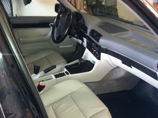

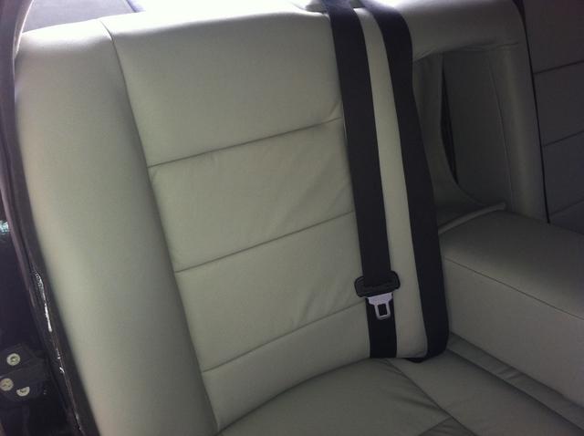

    ordered the leather seats from leatherseats.com
    guys were awesome. pattern was arhived, but they "pulled it" or whatever.
    $1050 shipped... full leather... front seats... back seats... arm rests... center rear armrest... AND new door card inserts in leather too.
    (haven't installed the door cards... )
    awesome fit, awesome service
    like a new car... supple leather... all the leather matches in tone, wear, etc... smells great.
    it's like driving a new car. ( the suspension updates helped too (sachs, dog bones.. poly subframe and thrust arms... all new tie rods...)
    very pleased... very easy to install just takes time and patience...
    it's not perfect because it's my first time.. few thigns i'd have done different... but was a fun learning project and I'm very happy w/the results.

    ***SEATS*****
    watch the videos at leatherseats.com
    - work from the inside areas (center of the seats) to the outside... from front to back...
    - make sure EVERYTHING lines up pretty closely (within an inch... inch & quarter max)..before putting the new leather on.
    - won't line up exact because the foam and batting, etc of the seat is expanded... and will squish down and let it all line up as you press and hog ring the leather into place...
    - BE GENTLE! the leather will give a bit... BUT if you pull or try to stretch TOO MUCH... you will create deform the leather, and where there should be a smooth area over the seat may end up with a little bag or sag... so if you pull or stretch... be sure to gently pull on the ENTIRE PANEL... not just a single section or area...
    - folks use a fancy steam machine... I don't have one and didn't use one...
    - it REALLY looks much better in person than the pix.... feels so soft...you don't know how brittle 20+ year leather gets in the sun... & smells great.
    - pace yourself... if you're not an expert it will take longer than you think. a lot longer... however the second ones go much faster (second front seat bottom goes half time of the first... same for seat backs... same when you do left and right brakes, right... so same thing here.)
    - be patient and fix all your bowden cables... align and measure your seat angles perfectly... clean all the dust out... clean your interior carpet while the front seats are out....
    that's all I can think of right now... I have some pix I'll post, nothing near as great as the giants on this board have done... but maybe will help someone.
