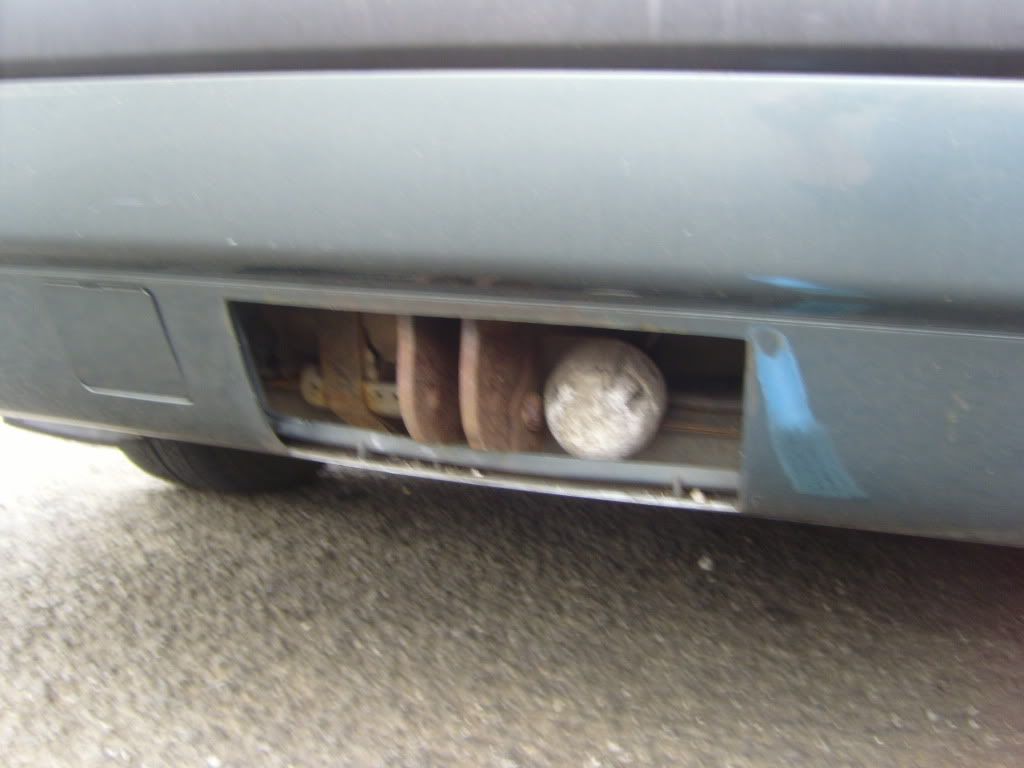

    Thanks for info gents! There isnt a tow ball hidden under the carpet. The hole in the skirt looks factory made and the flap that covers it has the correct BMW part no. and the paint matches. Maybe the original owner ordered the special rear skirt and had the kit installed in ZA? Doesnt look like an OE Oris/Westfalia or a Brink. Was hoping there would be a label on the inside of the flap saying who made it and rating but there isnt. It would handy to have a ball for it so this is what it looks like if anybody can help:

    I haven't seen one of those before. I have the factory Westfalia detachable horsecock and it's nothing like that. Could be worth a walk round a breakers though to see if any other brand of cars has a similar unit fitted.

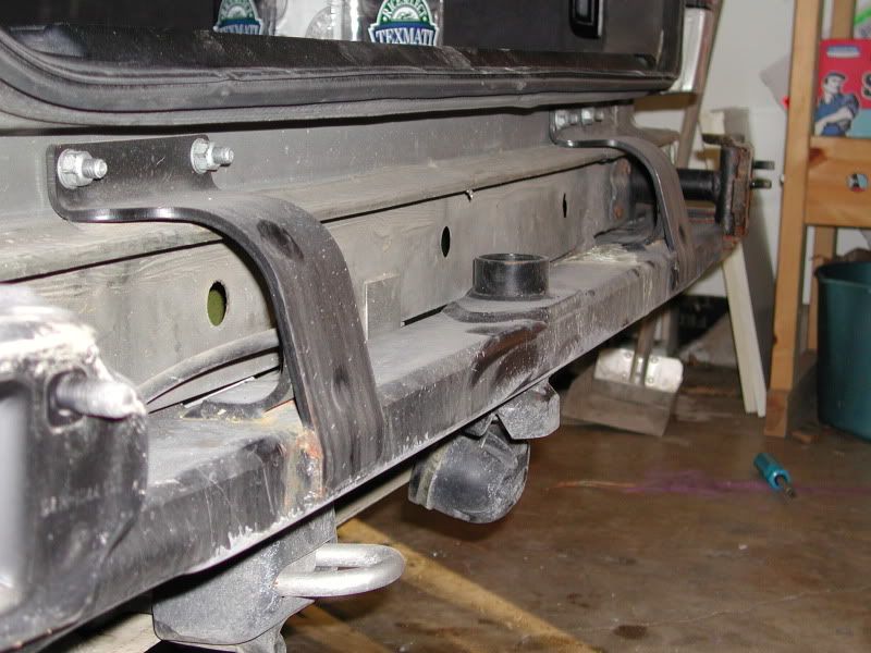

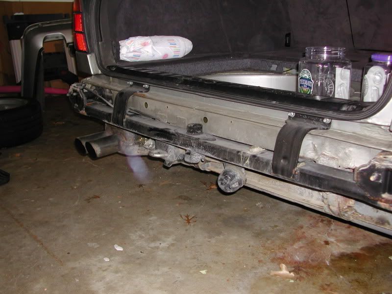

    Here's mine
    Get the model number and order a new horsecock for it and you are good to go. Also the 7 pin or 13 pin wiring adaptor will be easy to locate.
    Great find whiskey!

    ^^^that's exactly the same as mine Elekta!
