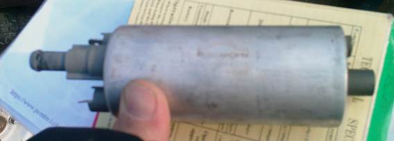

    One guy here offered a fuel pump from Opel. He says they are interchangeable. Couldn't compare as I couldn't remove the pump itself from the tank of my car. Attached pictures of the pump he is offering. Will it fit?

    Opel pump could work if it fits somehow, have already seen a Hyundai pump in an E32 730 V8 in South Korea and in Australia they use GOSS pumps for Holden cars.
    Maybe some small adjustment are necessary, but in General it will work if it fits into the bracket. If too small, usually the oump kit sellers for multi purpose after market application add rubber, connectors, wire.
