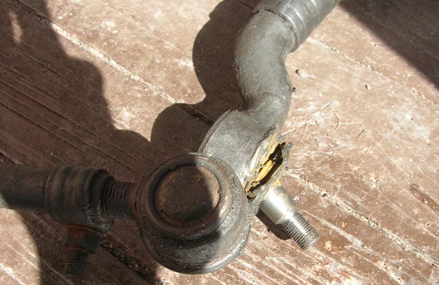

    I'm replacing the tie rods and idler arm. Everything's off and I have all new parts to go in except the idler arm bolt which looks like this after soaking overnight.
    It's not completely stripped . Having trouble finding a replacement, I found a self-locking nut that would work (on the left there), but I'm not sure if I should use it. What do I do? I won't be able to find a proper one until tuesday at the earliest!
    This was the balljoint that was making all the noise I think. It was a megabitch to get off. The rest was pretty easy.

    The bolt looks fine to me. Threads look okay and the bolt doesn't appear stretched.
    I see no reason not to reuse.

    Thanks. I used the old bolt with the new nut, and now my mind is at ease.
