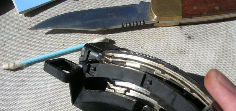

1. Remove the gearshift handle. Will require a small allen key to undo the retaining bolt.
2. Lift the forward section of the shift surround with a non-sharp implement, pull up 5" and then pull forward/up to remove.
3. remove and disassemble the auto shifter switch. Clean contacts, and repair the small reverse light contacts section that may be damaged from heat due to arcing. Re-assemble with **new** di-electric grease and refit.
4. test and refit the surround - you're back in the race.

Something easy for a change! I scraped the contact with a pointy knife and greased it up. Works! One thing I would add for anyone who needs to do this is to make sure you wipe off any grease that could cause a short between adjacent circuits.
Before I used the knife I had a look around to see how much a replacement would be and I couldn't find the part on realoem or anywhere. (Knowing this I was very careful with the knife)
#s on the switch are 04854815 and 1216079.
The contact in question is the smaller one lower left (small rectangle facing down if you follow me) - the heat damage Nick is talking about is very obvious.
Thanks again guys!

I've seen worse thoYours will work well.
One thing one want to be sure of is the contacts being really smooth, so 600+ emery paper is a good choice... that way the copper wipes won't wear out so badly either.
