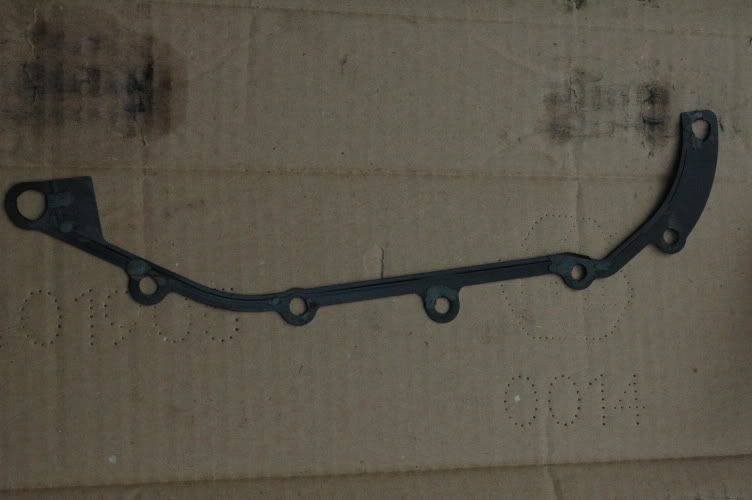

    The VANOS cover gasket, for lack of a better term,
    and the chain guide plus tensioner, if you are so inclined.
