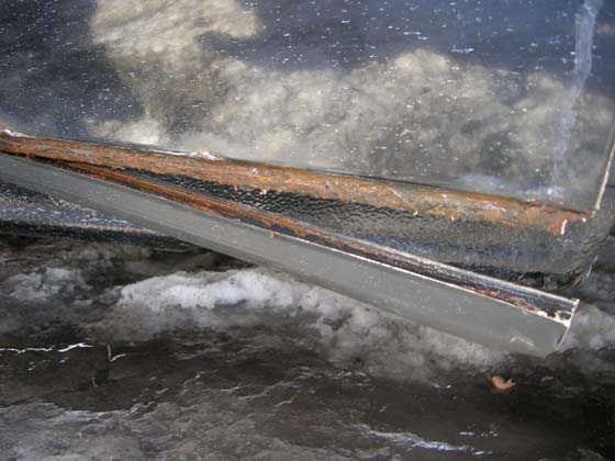

    pull it off at one end first then the rest comes off easy... see?

    Tim, the last picture scares me. I have rust on my drivers side doors and I am scared to take the trim off to see that.

    Quote Originally Posted by russiankid View Post
    be afraid, be very afraid.

    Quote Originally Posted by tim eh? View Post
    Holy $hit Tim! Time to move back to Alberta where it's nice and dry ......

    Quote Originally Posted by RockJock View Post
    that's the only one like that. maybe i'll soak it in vinegar. A1 for shock value that door trim... I knew there would be rust but... actually I was laughing when I took those photos.
