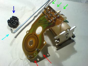

    Hi there, I definitely made the post. I've re-attached one of the photos from my original post. That post must have been in 2007, probably around April or May, give or take a month or two.
    You'll see from the attached photo that there are two red arrows that point to sockets on the printed circuit board (PCB) that is inside the cruise control actuator.
    As far as I can remember, the sockets on the PCB are meant to connect to the cruise control actuator motor (not shown in the photo, although the photo does show a solenoid) but the sockets were so old that they no longer made a good connection. I slightly bent the two sockets so that they grasped more firmly, and thus made a better electrical connection, to the motor. I guess with time the sockets had gone a bit soft.
    That's as much as I can remember so if you want to know more then you'll have to have another go at finding my original post. Good luck!
