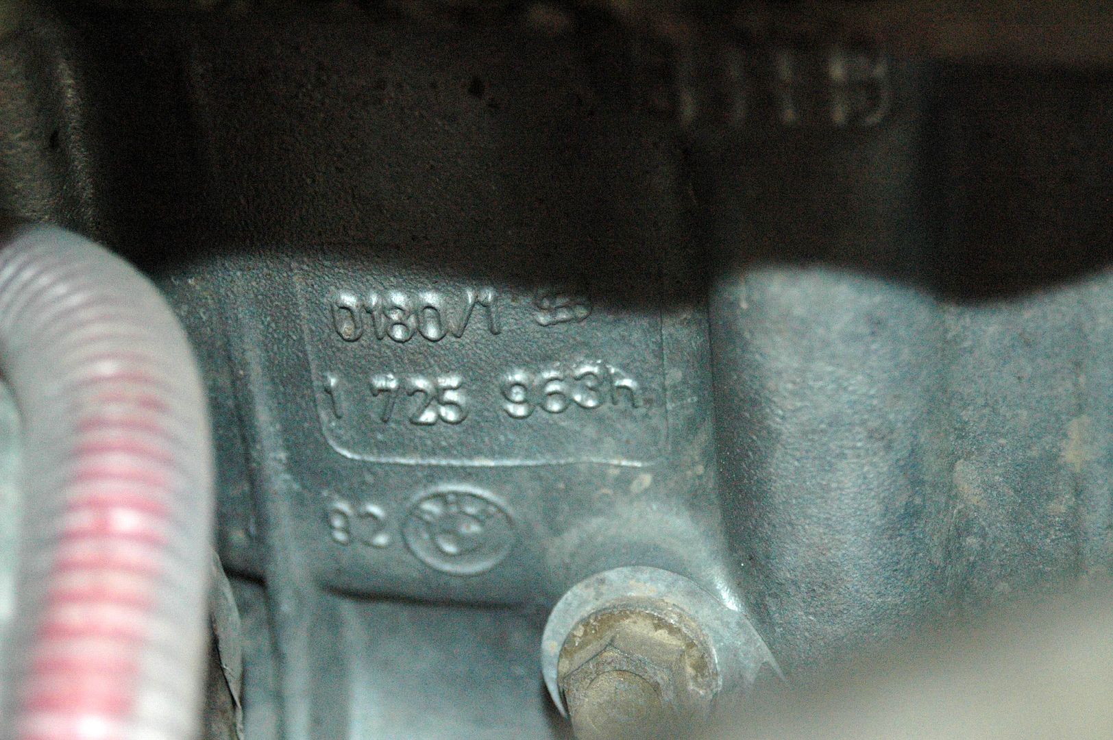

    Bring a lump of play dough. Press it against the block on the passenger side at the overhanging end of the starter to get the imprint. I suspect it is Nikasil unless replaced under the warranty program. If it is get the leak down done before pulling the trigger.
