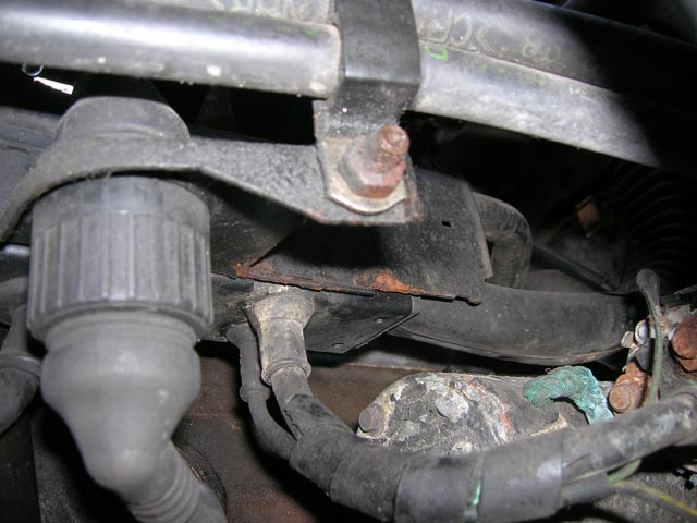

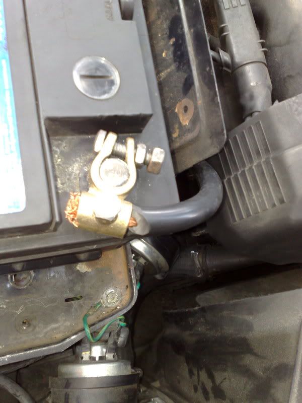

    just changed - cables from batt. to chassis including batt.post clamps. i don't drain overnight anymore but when everything is on esp. when aux.fan kicks high i still get low readings from obc. as low as 11.48 i guess im getting near to finding the prob though..hope this info helps a bit i'll post pix as soon as i can to show you guys how my old and new cables looks like.

    here's some pics of the old and new cables. Sorry can't take a pix of all the new cables.engine is hot.

    Quote Originally Posted by bmwrp8 View Post
    wow, that is ugly! that can't be a bad thing changing those!
    wonder what shorted out so bad? Bet if you find the short you find the problem.
    Quote Originally Posted by tim eh? View Post
    Aug 2008
    i have seen cables like that and it was just heat, humidity, salt and old age...
