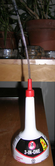

    well, my locks have been working like new since i doused them with this stuff a couple weeks ago.
    i didn't even have to take the panels off (well, the d/s was already off), the handy little tube was perfect for sticking it in the holes on the sides of the door. it's going to be real messy in there now but it's already full of rustproofing anyway.
    so what are the 3 oils anyway?

    Quote Originally Posted by tim eh? View Post
    Lubricates, cleans and prevents rust. Er... I think it says it on the can
    Aug 2008
    Quote Originally Posted by whiskychaser View Post
    oh... that's lame i thought there were 3 different oils
    well i don't know about the other 2 but it lubricates, that's for sure.
