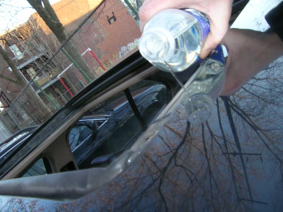

    To check your drains, you will need some basic equipment...

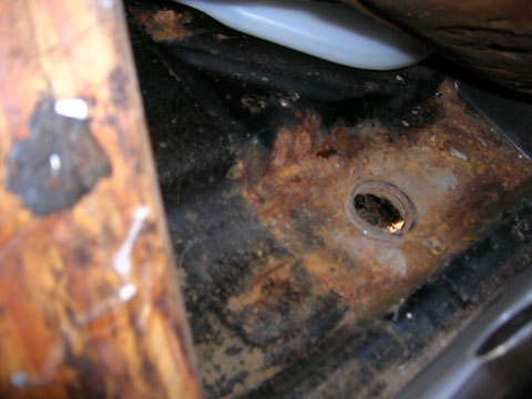

    The drainholes are in each corner of the sunroof opening.
    The rear holes are difficult to see but they are there.

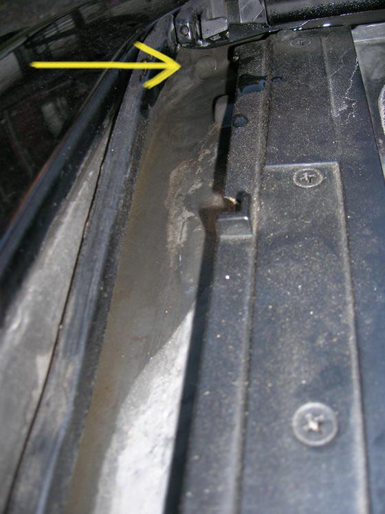

    Here is the front hole.
    You might have to park the car twice to do this test for the front holes and the rear holes.
    In this case, tilting the camera seemed to help.

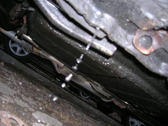

    What goes in, must come out - here is where the fronts drain on my car - near where the jacking points would be if I had them.
    And in the back - again near the jacking points.
    If you park on a slope it will affect the symptoms - the trapped water has a tendency to run around the headliner... this can cause rust along your windshield frame and doorframes. Eventually, the water will end up in your front footwells (bad and smelly) or under the rear seat (worse and electrically hazardous!).
    If you find that one of the drains is blocked, generally a blast of air from a bicycle pump is enough to clear it out...
