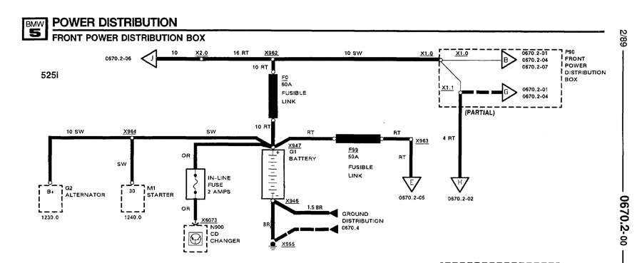

What do you guys think my chances are of replacing the batt/alt/starter cable are on a cold day? Anyone know where to start there?
diagram-> http://www.bimmernut.com/forum/attac...3&d=1226811139
photo-> somewhere in there (from alternator looking towards firewall)
***- i already saw shogun's thread
another diagram (realOEM link).. i can't find one of the starter cabling.

Be smart about this tim, make the cables inside in the warmth and then go outside, undo the bolts, (don't drop them) and then just install the new cable.
OR
Remove old cable, go inside, make one like it, then go back outside and install.

good advice - I'm really not sure about doing it in the cold. I usually prepare as much wiring as I can indoors... **** I have done a lot of wiring.
I just can't find any info on which bits to take off to get to that cable and connector, and more important what not to break!!!!
Such a pain in the ass going to a shop right now with snow tire's being mandatory in 2 weeks. I'm so incredibly sick of this.
***- and what about that connector? so long as they are all attached well and solid and nowhere near anything else it should be good.... right?
