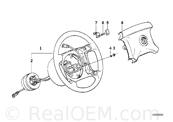

    Part #2 in first photo is the slip ring. Link below to remove steering wheel.
    http://www.lehrmangroup.com/rickard/airBagAndBulbs.html
