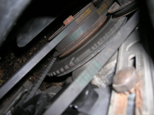

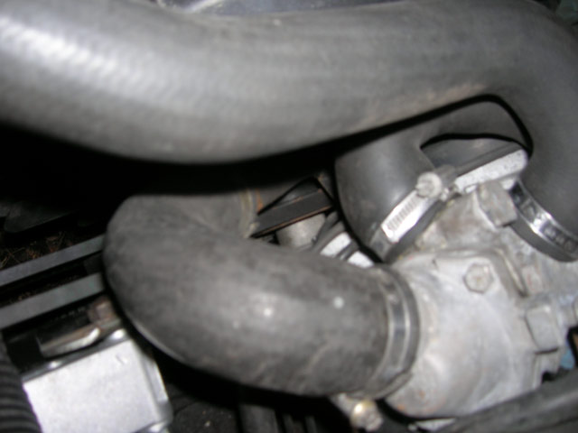

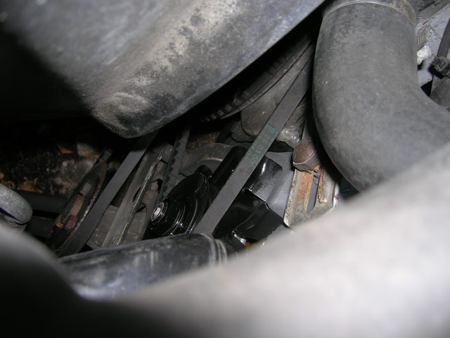

    Could somebody check my m20 alternator belt routing please? pic1 pic2 pic3 If I routed that wrong I will be embarrassed but so very happy. It's tight, really... it's really tight... I have tried it at different tensions and it doesn't change anything.
