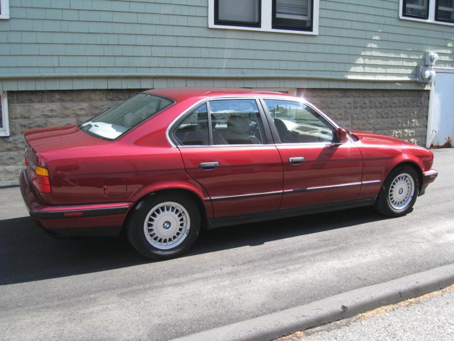

here's what my car looks like with my suspension setup:
It's already been said, but I'll add to it. Just say no o the BAV Springs, go for the Eibachs & Bilstein Sports.

Eibach pro kit ($400) and new stock boges ($75 each) with 3mm pads. These are not very flaterring photos, but you get an idea of the drop. Its lower than most I've seen, especially in the front.
