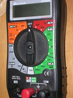

    i don't think my meter has the right setting for a static draw test... i tried with it set at 200mA DCA which is as high as it goes - am i doing it right?

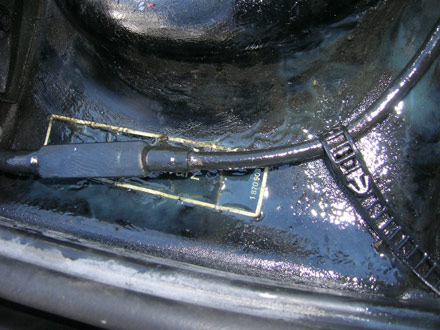

    sorry the photos are lame it's hard to do it all at the same time. that rustroofing crud is soooooo gross!

    so that means i have 0.0mA draw when everything's off?

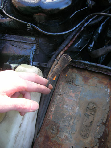

    ...wondering what this plug is that comes out of the wiring harness that runs down the side of the washer fluid tank. any relation to this?
