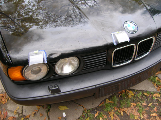

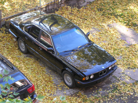

    well we've had some nice weather it's around 60f/16c and i've managed to slap 2 thin coats on so far. it's kind of fun dodging leaves and such and there is next to no preparation involved so it's super easy... i like the dent it's a testament to the sand/grit trucks.
    wondering about a couple of things, i am willing to guess tho...
    i only added about 5% thinner to paint, and i'm thinking with that i can do 2 coats today(?) about 6 hours apart...
    here it is 2 coats in- i'm overkilling this job i'm going to do 5-6 coats so i can sand fairly liberally.

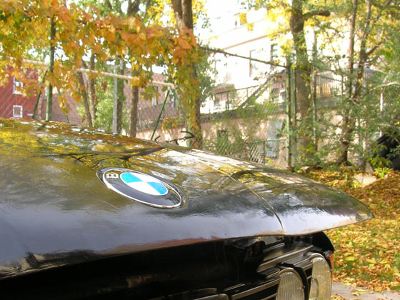

    this is after 1 coat you can still see the primer.
    Aug 2008
    even after 1 coat it looks good from a distance, but so does ross (love your sig dude).

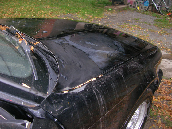

    here it is after primer - the monkey is thieved from the stickied end of the world thread but he belongs here i think!

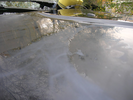

    3 coats in and i'm starting to realize that i'm no bondo-whiz
    ... i'm no picasso either, here's a 4th coat pic
    no choice but to slap another one on i guess , the paint's drying nicely at least - too bad i won't be able to blame it on that.
    might have to make an appointment with the pros... we'll see...
    maybe this can be thread about how not to paint your car.
    ho hum... watching paint dry...

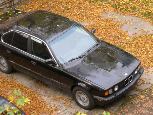

    How come you haven't popped the roundel out while you're painting the hood?
    I think it is turning out rather well. Water repels from new paint from the chemicals leeching out. What kind of paint are you using? (not brand but type)

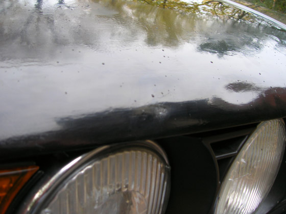

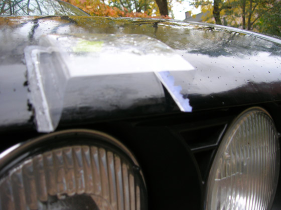

    ok so it's been raining all day : (

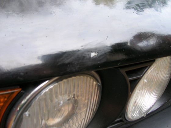

    i decided to sand the 4th coat and see where i stand.
    and i think i hit a roadblock (i knew i would).
    i'm wondering if the hood has been sprayed with clearcoat at some point.
    for reference, here it is after 4 coats... the dull bits are the new paint.
    i sanded part of it down to do a test buff... what's the white stuff?
