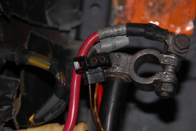

    Lookin good?:

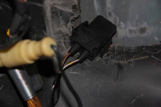

    What is this #1 (same side, next to batt.)?:
    What is this #2 (same side, next to batt.)?:

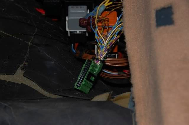

    What is this #3 (other side of the rear seat, drivers side)?:

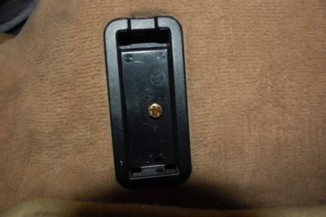

    And the object below the rear seat, on he batt. side it has a cover (over the carpet) and nut, it appears to be some kind of grounding thing...what is that?

    1 is fusible link.
    2 is a connector... not sure what it is for. I think I got one of that too disconnected.
    Don't know about the rest.

    Yea I'm trying to figure out what those 3 connecters are, and what that ground thingy is also. Heres a pic of it:

    the connection below the seat cushion is the main ground. Behind it is access to the connection. Handy way to disconnect the battery without removing the seat if the car is to sit a while. 750 owners REALLY appreciate this as the rear seat in those is a real bugger to r&r.
  8. #38
    La Mirada, CA
    635
    really i can disconnect the battery from there??? do I just undo the bolt?
    Yep. Have a look where the negative cable goes to while the seat is out.
