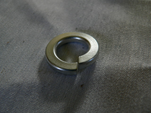

How are your Hong Kong Foglamps doing? On one of mine the clip wire has been problematic. Since the bulb grounds to the metal surround of the ballast whenever that collar loses contact with it the CCM throws the Fog lamp message so I went to Home Depot or Lowe's and got a steel locking washer,one of those with a cut thru it which allows the connecting wire to slip thru and it acts as a shim between the collar and the clip so it doesn't lose contact with the metal..
