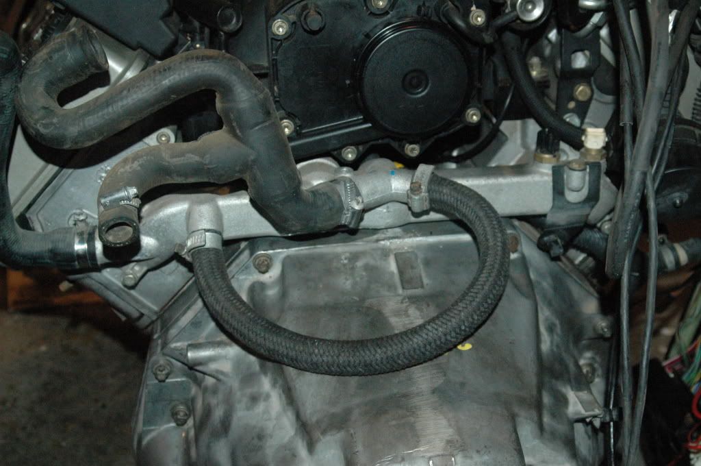

    Back of the engine picture. Ignore the hose loop. Your automatic has one hose which goes down to the transmission cooler on the driver side and up the other side.

    Quote Originally Posted by yaofeng View Post
    So, you must be talking about parts 6 & 7 here http://www.realoem.com/bmw/showparts...47&hg=11&fg=35
    And as you've pulled your auto out you just looped those two together, right?
    Will try looking at those when I'm underneath the car Sunday during my strut assembly swap.
