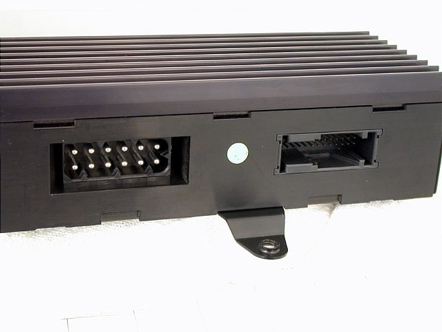

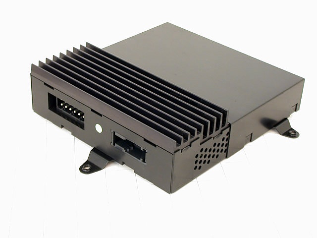

    Bingo ... open it up and it's all circuit board and small components,
    not like this
    That i would have hacked in like 15 minutes.
    The old style plug on the left was no problem and i just tapped to the back of the connector, which can be separated from the amp box. But the one on the right was just too messy trying to get decent thickness wire on. Still, that takes care of connecting all four woofers with a single ‘click’ and i only had to connect the mids/tweeters and head signal in the car.
