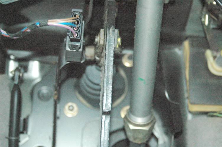

    How about the clutch pedal rod is adjusted too long, causing the piston inside the clutch master to cover the access hole to the reservoir. Then there is no place for the expanding fluid to go but push back on the throwout bearing.
    You know, this inability to flow fluid back to the reservoir as the slave heats up could have taken out the two year-old clutch job...
    The way to eliminate my hypothesis is to undo the clutch pushrod from the pedal and see if the master cylinder pushes back a little and your run-away slave calms down. This should be a quick and easy experiment.
    I figure there is some spec for the pushrod adjustment but I don't know it...sorry!

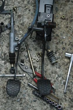

    http://www.bimmernut.com/forum/showthread.php?t=38792
    East Brunswick, New Jersey
    Quote Originally Posted by bsell View Post
    How did the flywheel clean up with the sandpaper and water trick?
    Brian
    I don't remember anything adjustable on the clutch pedal when I removed it during the 6 speed conversion. Everything seems to be bolt hole to bolt hole. Am I missing something?

    Oh my you did that the hard way.
    The rod length is adjustable at the clevis. Or is it?
