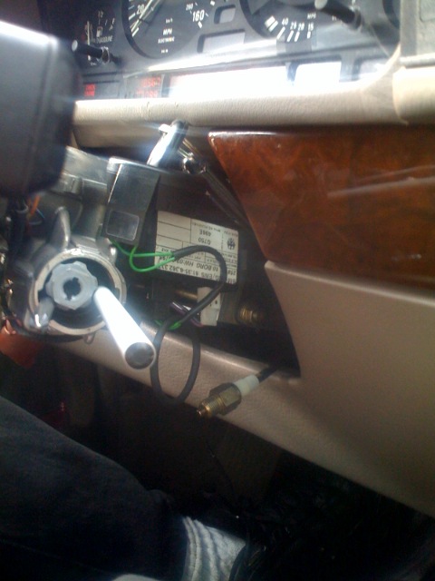

    Well, I didn't take the steering lock off, I took the lock cylinder off, and pulled out the broken part out of the inside and stuck that OH SO HANDY BMW screwdriver into the steering lock, along with a bic pen. This pushed down on some mechanism in side the steering lock which unlocked the wheel. I just now drove the car home, and now I can take my time to fix correctly (using the bubba procedure above to replace the steering lock). I'll take more pics when I get a chance. Thanks again guys.

    Ed, since you have access to the security bolts now try giving them a few raps with a sharp chisel along the edge before fooling around with Dremels and such. They don't require much torque to loosen.

    Funny Ross! Those bolts were torqued down so much that after I dremmeled slots in them, The screwdirver, with pliers on them, simply stripped the slot. I dremmeled the whole head off, and got the palte off. I think Arnold was working at the factory that day when this car was built! lol

    Glad you got them off anyway. When installing the new bolts you'll see how little it takes to snap the heads off.
