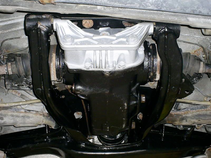

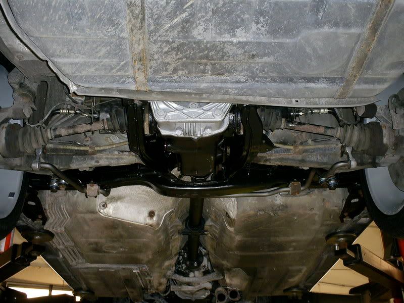

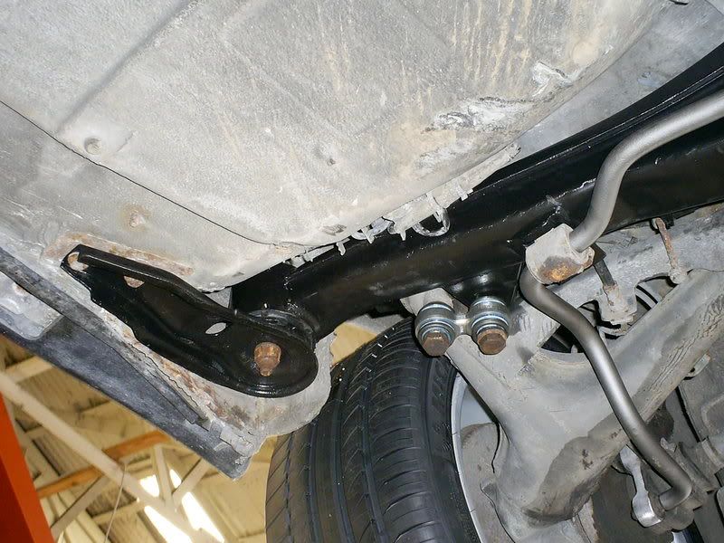

    yeah, but a new rebuilt driveshaft is $600 installed, so those bushings are real cheap compared to the pending breakdown of more important stuff.
    That center support bearing bushing is integral to the life of your drive shaft. So are the rear subframe bushings as are tranny mounts, etc.
    ask me how I know?
    Nice pics, thanks! Can be used for future explanations and go to my archive ;-)
    Austin
    1,087
    take what you want, I have thousands....two tourings worth
