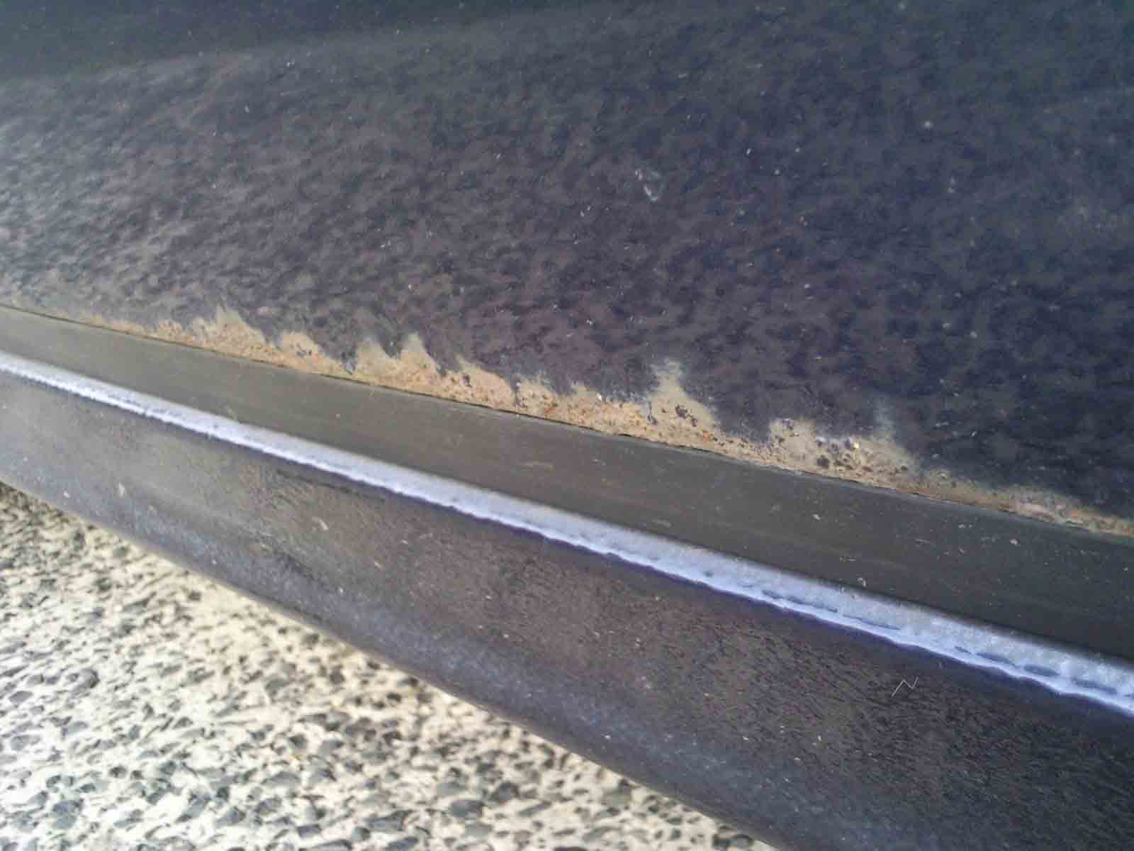

hi, i have some pics of the rust. it looks like the paint has bubbled and rusted.
sorry the pics are a bit large i didnt know they would come out that big lol

This is why you should shoot a blast of water behind all your pieces of trim. Water doesn't cause rust; the junk that builds up behind the moldings or in the bottom of the door and keeps it wet, and contains contaminants, is what causes panels to rust.
We've fixed a lot of rust and that looks like it's all the way through the panel. You can't see through it now, but soon as you hit it with a grinder... swiss cheese.
Rust Mort by SEM is another good product, but that really serves no purpose for you unless you're a body man because that mess needs to be ground off, treated on the inside, and then patched with sheet metal. There is really nothing you can do to stop it from getting worse at this point, except having it repaired.

Think Mr Angry answered that But if you dont want to swap panels and are really handy with filler and paint you need to:Originally Posted by dwaynos
1. Grind away all paint until what you have got is clean solid metal
2. Bend the edges of any holes inwards. That includes any pits
3. Fill holes with filler. Big holes you need metal gauze as backing
4. Sand back and fill any pocks with cellulose stopper
(use a block, wet and dry and plenty of water)
4. Prime x 2 and flatten
5. Mask and spray top/varnish coats
My guess is your big problem will be the very bottom of the door. If the seam is shot you have nothing to guide you or fill against. If you havent done this before-and I guess thats the case-you might be better leaving it to someone like Mr A. You are going to be feel pretty sick if you spend a weekend trying to fix it and it ends up like a dogs dinner. No offence
