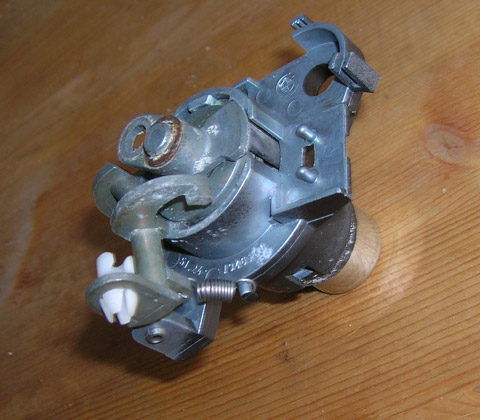

I'm a little confused about if the trunk is locked or if it just won't unlatch due to a rod falling off or something.
Another thought is to gain access to the area around the drivers side trunk hinge where the harness always fails and jiggle it while someone else attempts to operate the locks. If you pull the back seat out, the package shelf and the left speaker you could get an arm in.
The GM is the general module, the RM is the relay module, both live in the electronics box under the rear seat on the driver's side. Remove it's cover and you'll see them side by side. In the nomenclature on them you will notice RM and GM somewhere. They just lift out. Probably no need to undo the LKM, light control module.
BETTER YET-- With the modules removed the circuits I suggested accessing through a door are readily available in that e-box. The blue wire terminates at the RM pin #1, the white at pin #13.
