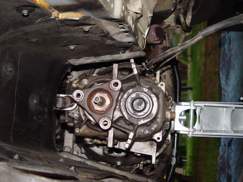

    Now to the transmission. I have removed 8 bolts and have completely and utterly stripped the **** out of one. It sits about at 10pm on the transmission and I'm at a complete loss of where to go from now apart from pulling the motor out (if that happens the same motor isn't going back in *hint-hint*. I can barely get my hands on it and thats about it. Any ideas?

    No way I can drill it out because of where it sits. Tranny is sitting off its mounts on a jack right now.. no more room there. I'll go buy one of those stripped bolt removers, does anyone have a picture so I can see what they look like? I'm guessing a place like northern tool would carry it.

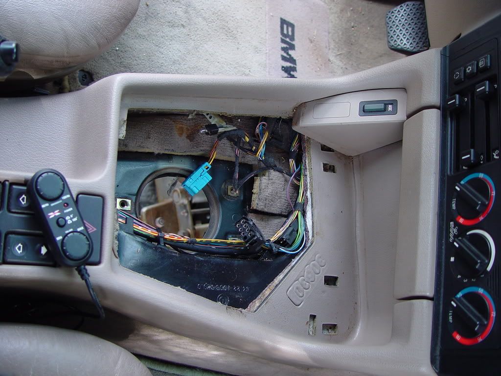

    Shifter pannel:

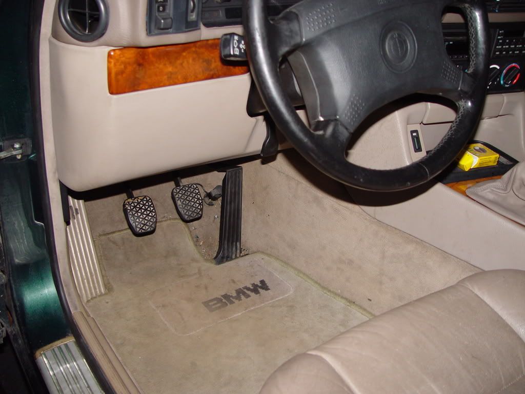

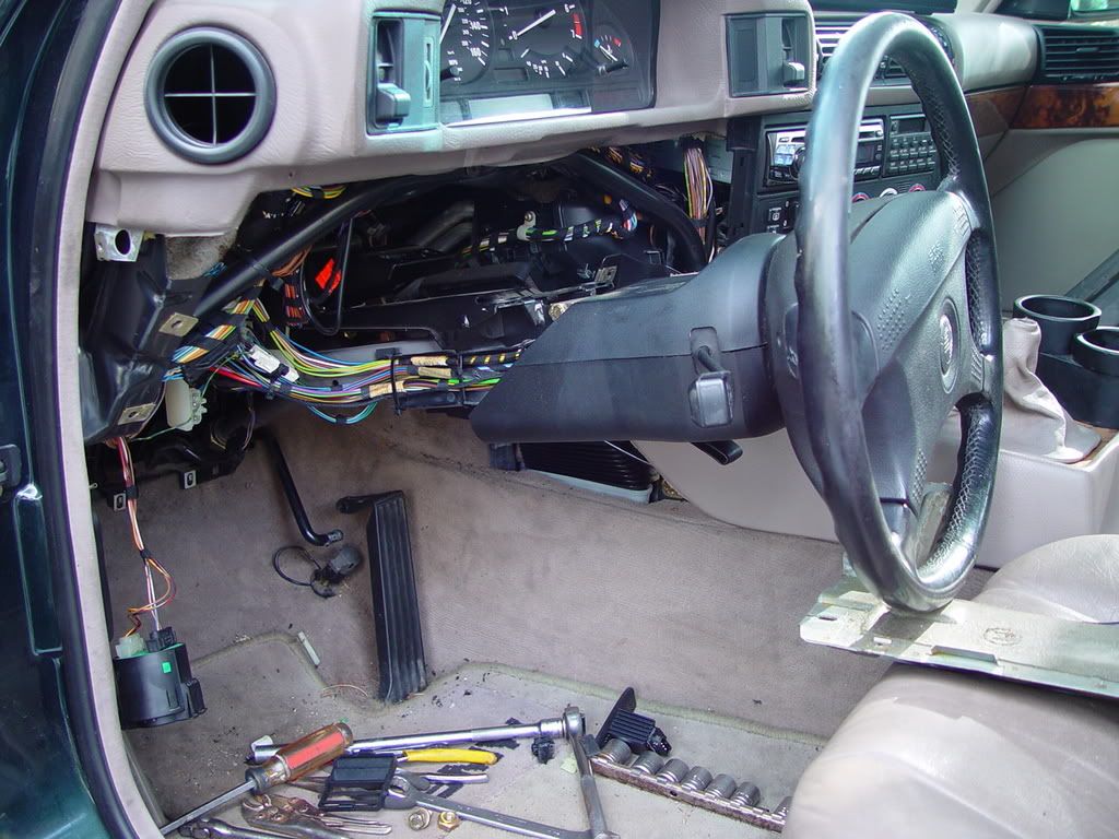

    Then continued on to the pedal box.. whatabitch. Used a sawzall to get the "safety" bolt out

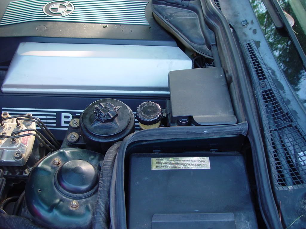

    Also worked out the hydraulic lines (and installed the clutch fluid tank):

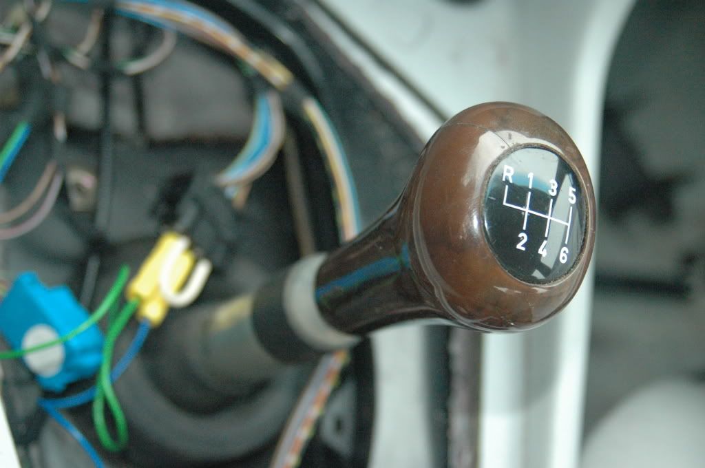

    Don't know how the 5 speed is different from the 6 speed. When I did mine, I need to add the reverse light switch connector since it was absent on the 5 speed auto but the switch is on the 6 speed gear box. The connector is a generic Bosch two prong connector. I made use of one I pulled from a 94 SAAB 9000 I parted a few years ago.
    The green and blue wires go to the reverse light switch on the gear box, if I remember correctly.

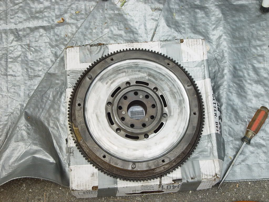

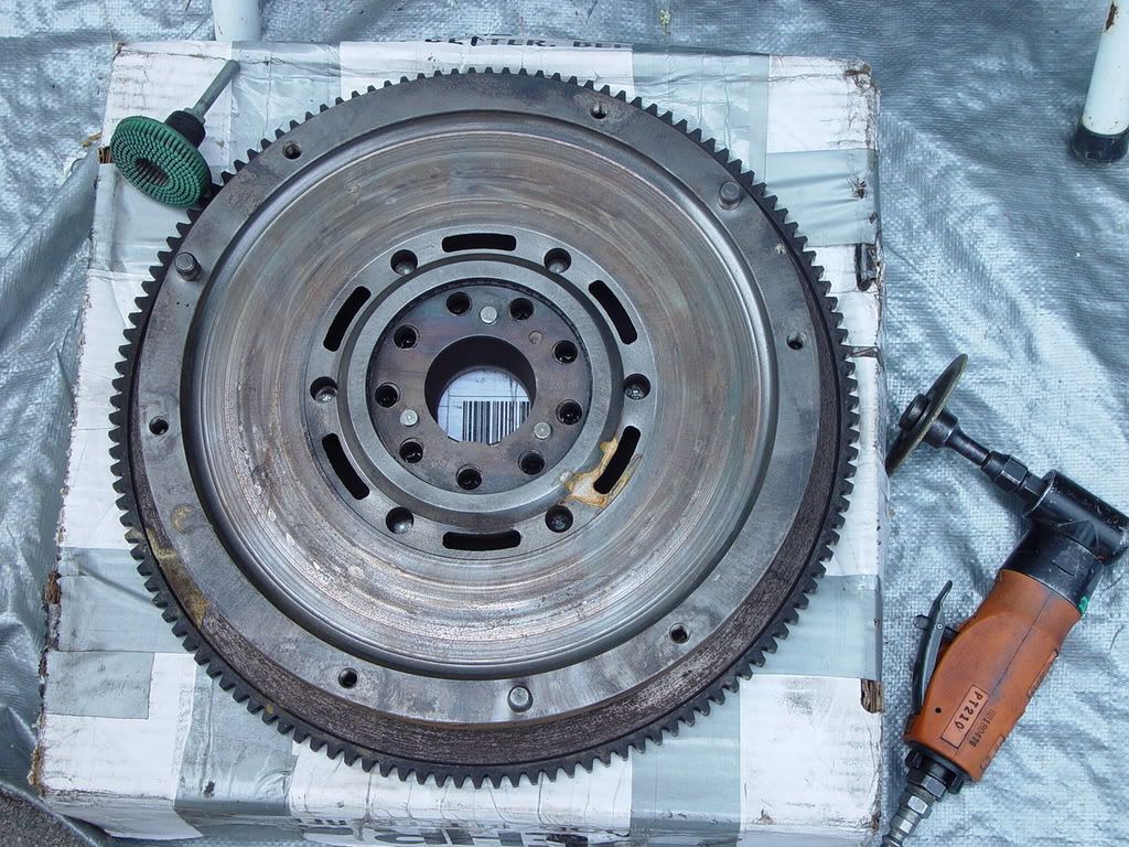

    Went to the clutch and brake specialist today to pick up my flywheel. He tried many different methods to resurfacing it but in the end nothing worked. So i brough it home and did some cleaning of my own:
    after using the die grinder with a special end i got this result:

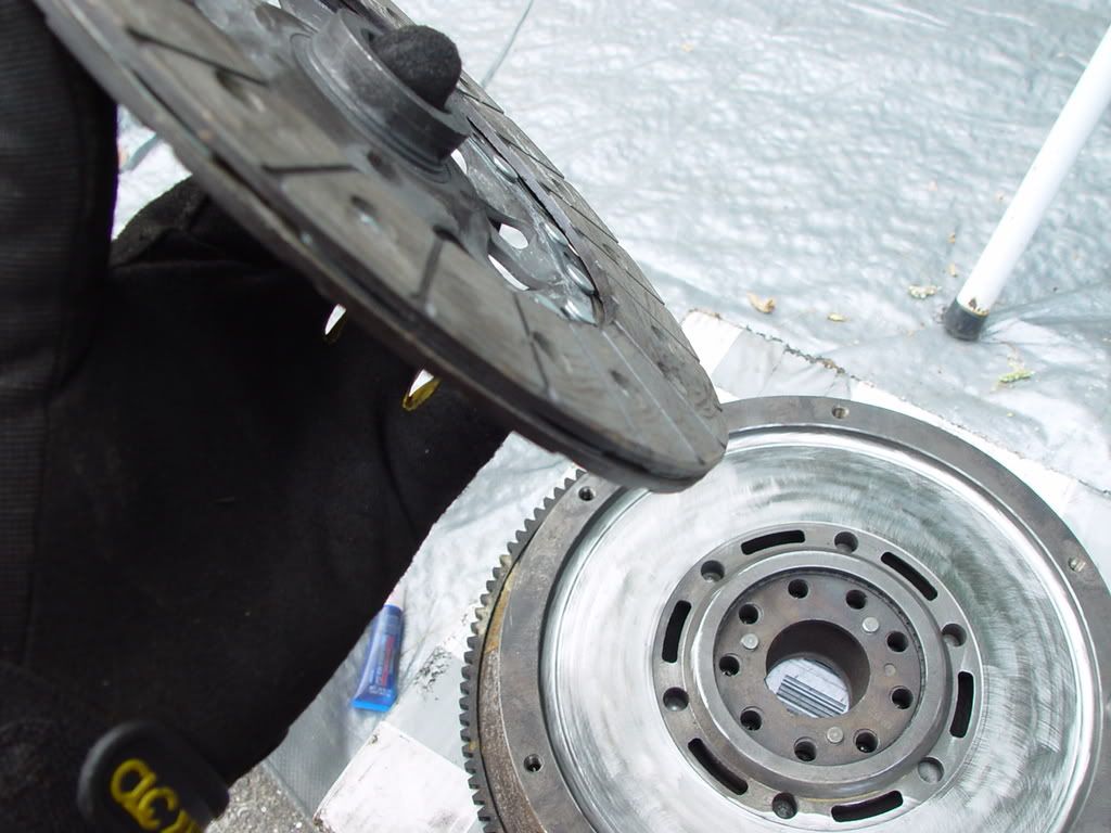

    i also soften the edges on my clutch with the diegrinder so it seat itself better in the existing ridges (per clutch man's instructions)

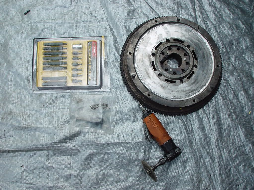

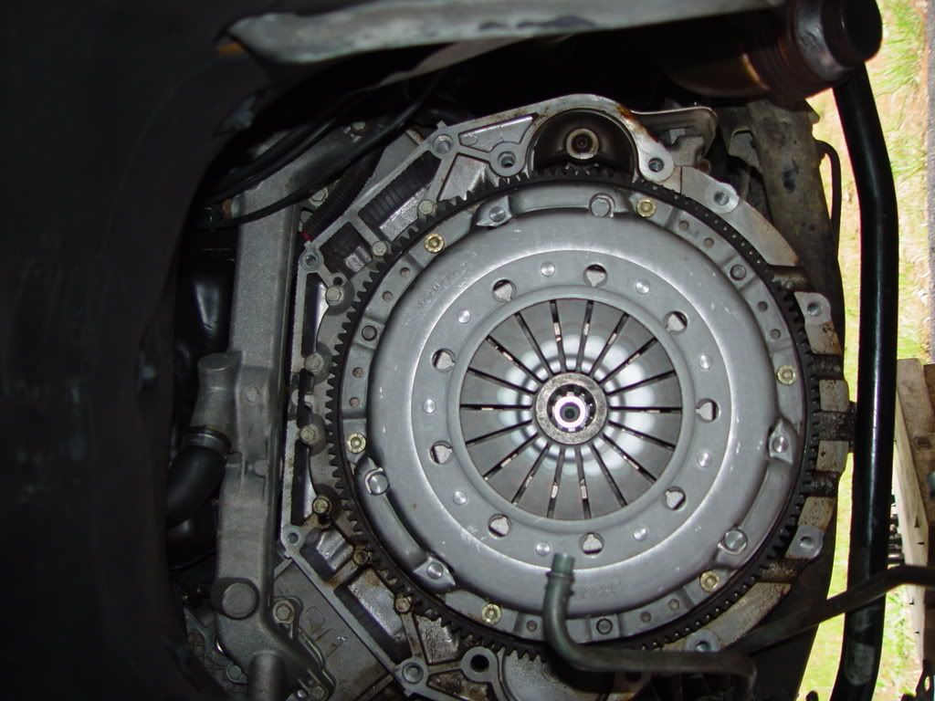

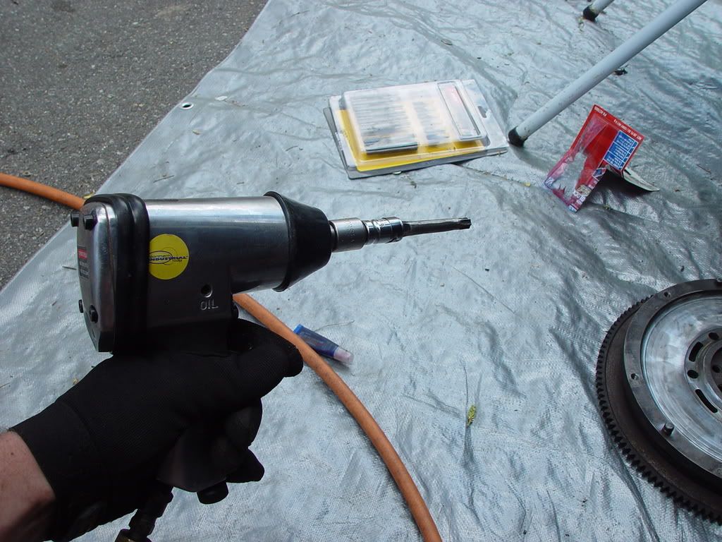

    After being happy wih those results I went and tried to attach my flywheel with the special (read: $50) tool I got the from the stealer... but it was the wrong size: AARRRRRRRRRGGGHHH :-/
    So I tried to find another tool that would work locally.. Advance had the torx50 socket as part of a kit, so I bought that. Didn't fit so I took out the diegrinder again to make it smaller.
    End result:
    Got the flywheel+clutch In.. But am worried about the amount of torque I got on the bolts since Ross told me they (the torx bits) are weak and will snap.. hit it with a heavy impact wrench for about 5 secs each + red loctite. That *Should* do it.

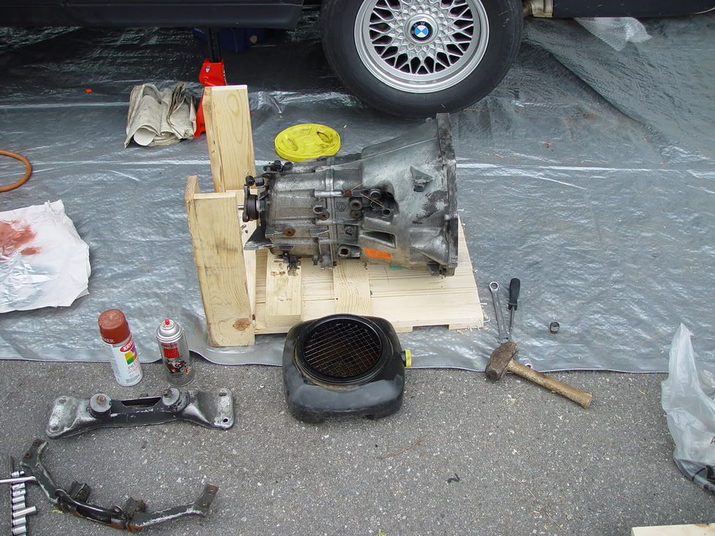

    After that I got inspired and got the ole tranny in der
    That's it for today!

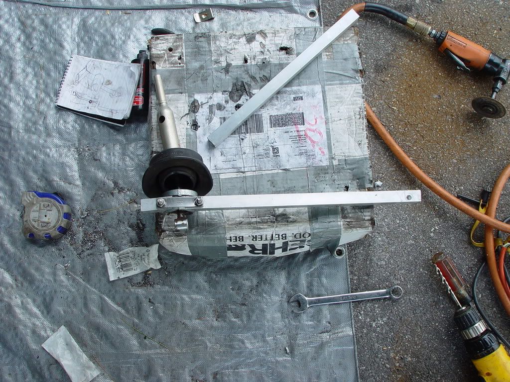

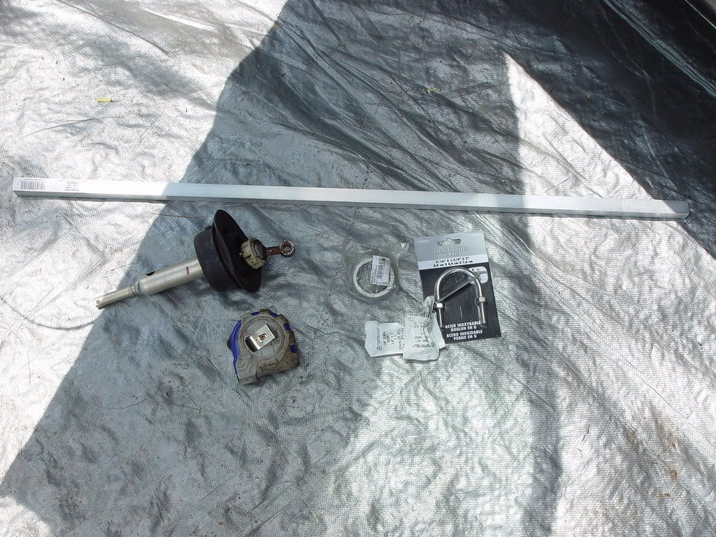

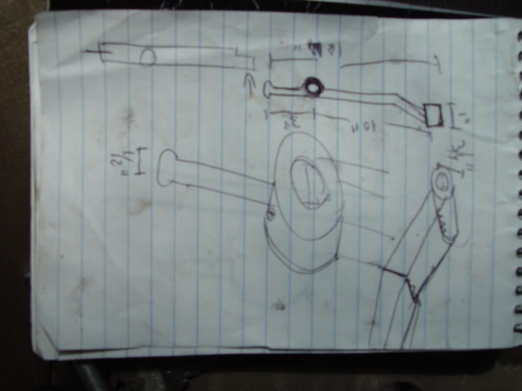

    Was a delay in the progress because i was missing my shifer carrier.. so i made one:
    Plans
    home depot parts:
    Finished product:
    gary likes:
    Shift is notchy & tight. I like :-) even if it is only a temporary fix.
