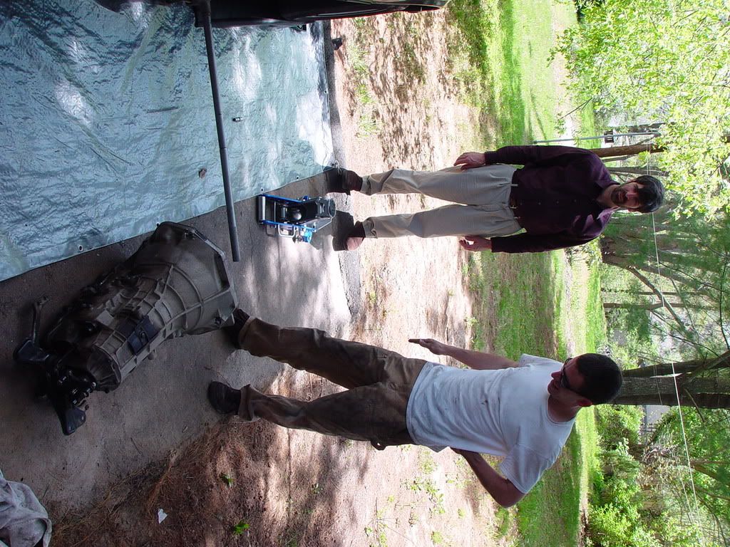

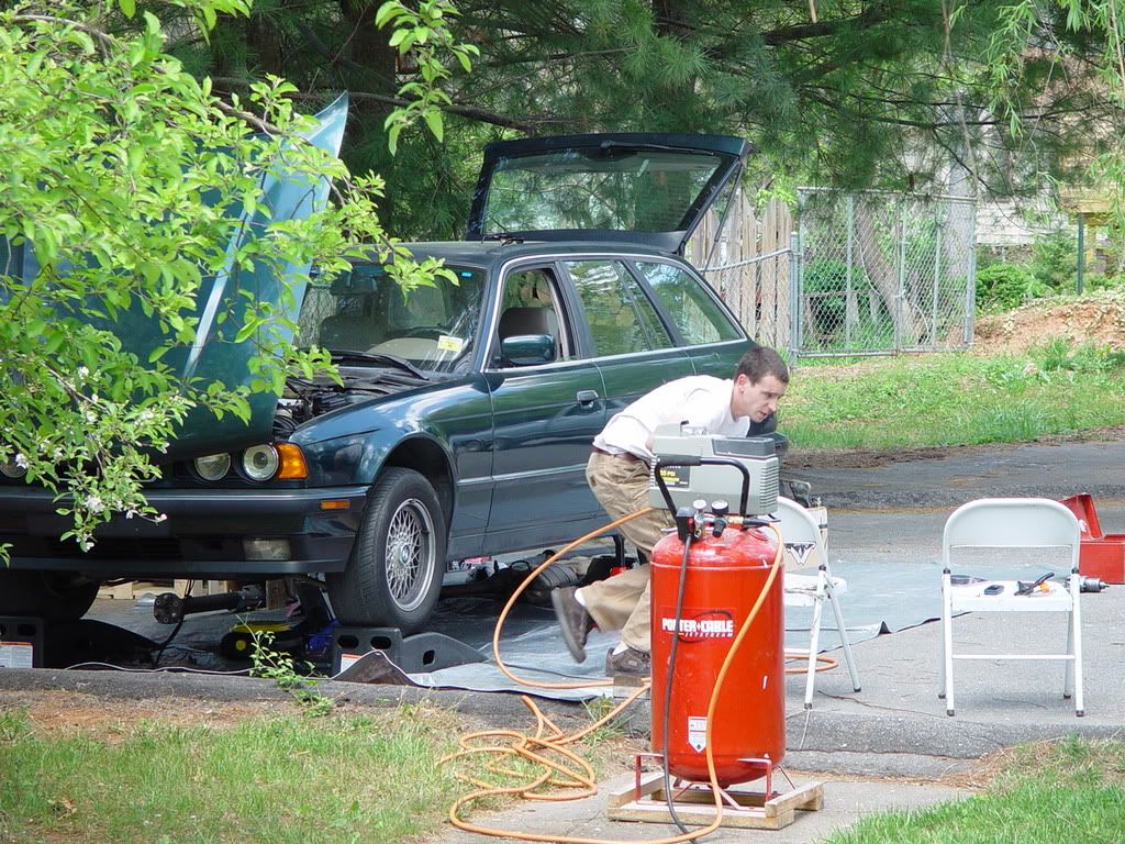

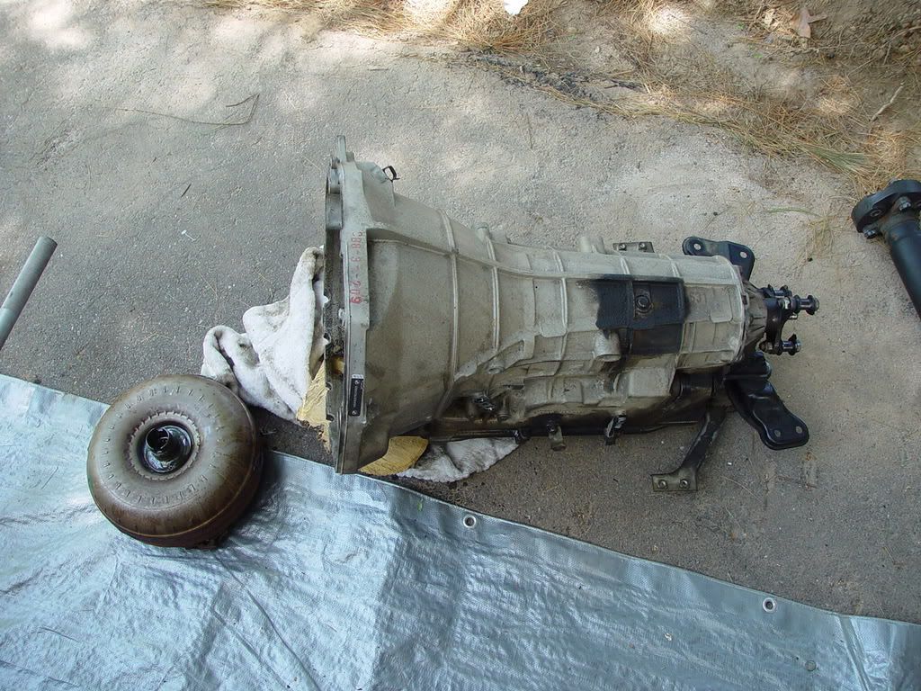

    My neighbor dougal came to the rescue with a a diegrinder
    2 more bolts out, and bam!
    And here she is.. a working 5hp18
    More updates to come!! Picking up the resurfaced flywheel+tacos now
